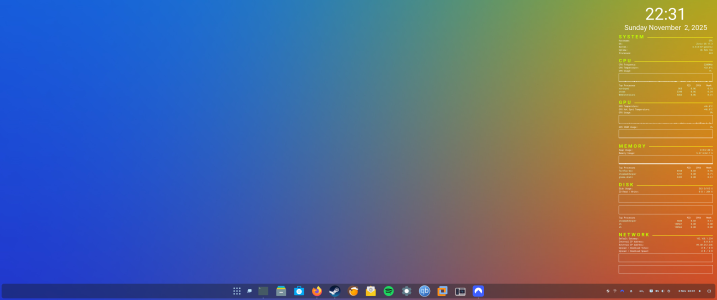

So I always use Gnome because I can set up my "task bar" at the bottom how I like. I have a wide screen monitor so I like everything in the center, and Gnome will do that beautifully. As you open more apps it'll keep the taskbar centered to the monitor.
If I try to do this with KDE it'll center everything but if I add or take anything away it wont stay centered. It only has a "centered" option rather than a "monitor centered" option. Its also a PITA to even do that, you have to dick around with spacers rather than tell it "yeah, just keep everything in the middle"
My bottom bar is set to hide automatically but I need it to look like this rather than an unsymmetrical mess!

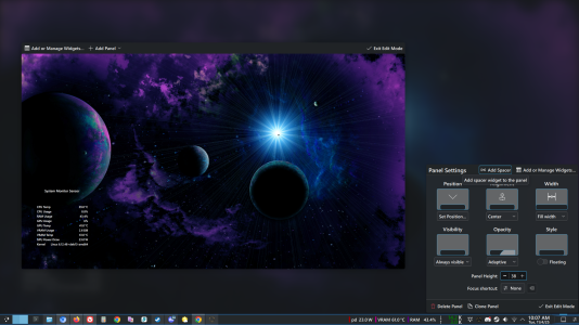

I'm at work now on my plasma setup, and clicking around, it doesn't look like you can do what you want; not with the builtin tools anyway. You might want to scour the web, or poke around in the internals to see if you can hack something together. Maybe try a forum dedicated to kde, or submit a feature request if you absolutely can't get what you want.
Yeah @WelshBloke add a flexible spacer on both sides and it stays centered beautifully.

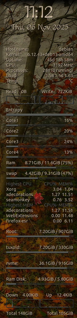

You can even do that in Cinnamon btw.. since I did that for my wife's weather and date and time widgets.
@WelshBloke can you share your conky script?
I tried someone's but it's not even close to what I want but yours is.
I will when I get home!
Remind me if I forget.
Edit: it needs fixing up a bit. I keep meaning to move the column titles over a bit and put some of the other networks in there, or split off the network stuff yo the other side of the screen and have the WiFi, ethernet, and VPN adapters all on display instead of just the WiFi.
So mine is a modified version of someone elses, Ive left the references in as they are useful (and its the right thing to do). This conky.conf is fairly basic compared to some of them.

This worked!
The panel transparency seems a bit funky but that might be because I'm running it in a VM.

This is my conky. I think I've been carrying it since 2009, modifying as necessary to stay up to date. My cpu temp is broken, and I haven't made the time to fix it. Probably has the wrong interface from an older computer.
Nothing fancy, but it gives info I like to keep apprised of day to day. I *really* liked vista's sidebar with gadgets people could write. I've run with a sidebar ever since.
I don't have it working with Conky yet but I'd basically try to do this and add date/ time and temperature
It worked except the GPU thing.. but it did give me a base line.

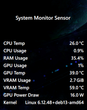

I somehow need to get the conky script for an AMD GPU and all I really want to display is GPU and VRAM temp and VRAM usage.
Basically the graph I showed you in the other screenshot.
Still look at other people's scrips.. maybe I can combine it.. but I noticed yours has the template and most of them don't!
you need radeontop to show AMD gpu stuff I think. The conky I posted should work with that, thats what I use.
Found something closer to what I want but still very far on the GPU bit..
