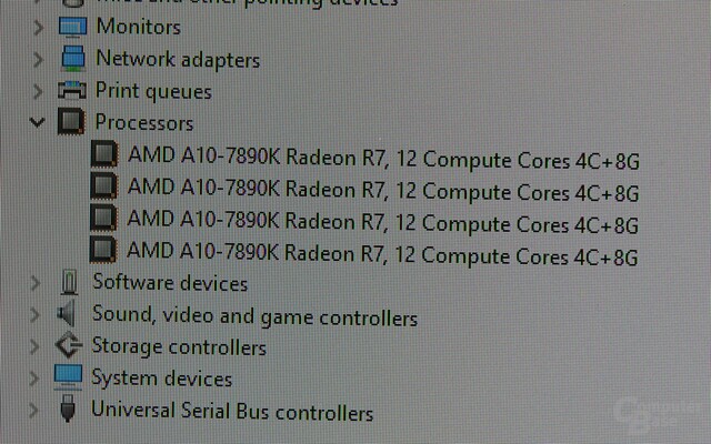

A10 7890K was finaly released but it s logicaly a 95W SKU...
http://www.computerbase.de/2016-01/...10-7890k-gezeigt-in-wenigen-wochen-im-handel/

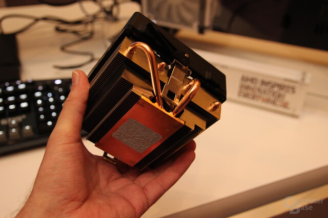

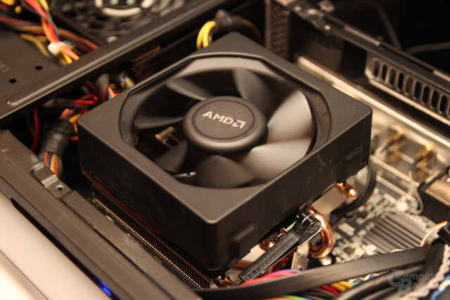

Other than that the 7890K benefit from a new cooler wich is very good according to Charlie at SA and wich will be also used for some FXs.
https://semiaccurate.com/forums/showpost.php?p=251972&postcount=14
