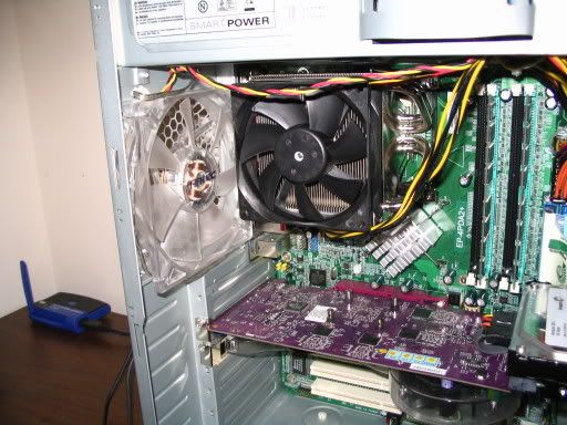

Yea, for the price this heatsink is amazing. I took some pictures just to validate my claims, case was open for the pics so the temps are a little below average. Room temperature is about 70F.
CPU-Z and Speed Fan
Cooler Master Temp Probe
XP-90

wow!!!! i just finished installing it and i clocked up to 3.3Ghz and im at 31 degrees idle!!!!!!
im highly impressed.
one minus is that the heatsink was a complete pain in the royal butt to install. thats just me... i couldnt get the 4th clippy thingy to click on the mobo rentention board for like an hour. but i finally got it on and BOY was this 30 bucks worth it! and i didnt use AS5. i just used the paste from thermalright. im saving the as5 for my conroe build.
Putting it on is actually very easy compared to taking it off. The XP-90 is an excellent heatsink, but the one thing I don't like about it is that it's an absolute PITA to remove.
