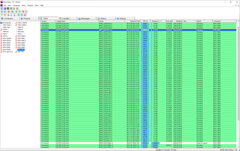

Interesting good or bad ? This is a retail CPU BTW. Here is a pic for performance purposes.

M97 is not bad..... And QA for the 9554s I have is very close to retail. but the QS 9654's say 2.4 base, and the QS's say "2.15 to ...." Mine run at 2.7 fully loaded, all cores. so worse case 250 mhz slower, but $1800 vs $4850 is a BIG difference. (QS to retail)

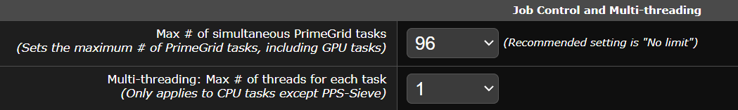

I got it to 96 tasks ! Here is the updated CPU speed
CPU MHz: 2323.496
CPU max MHz: 2400.0000
But the temp is holding at 66.
Power usage is 565 - 24 video - 24 (min) ram - 9 (6-12) for fans - 5 for NVME or 503 for motherboard/cpu approx.

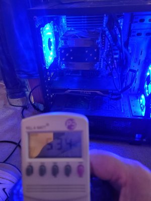

@emoga That pic shows the M97 cooler available on ebay for $78, and the power usage at 534 total per kill-a-watt in the system that I have for this 9654.
Appreciate you turning on your 9654 and finding that out for me. Thanks again 🍻
