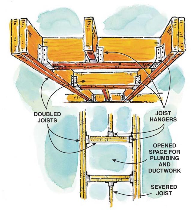

My plumber came over too last night to help consult on the bathroom install and pointed out something we had missed. There is a floor joist exactly in the spot where the p-trap for the proposed bath tub would need to descend into the basement and then connect with the rest of the dwv stack. I mean the joist is literally on center with the tub drain.
I envision needing to do something like this:
Sever the joist in the way of the p-trap and sister the joists on all 4 sides of the opened space.
But, this is on the edge of the house and one of the joists on the side of the opened space happens to be the rim joist resting on the basement foundation wall. Id imagine Id sister this the same way....
