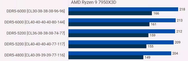

You can run JEDEC but you'll need to tune the timings otherwise you're losing out on 15-40 FPS depending on the game on lows and averages.
Timings are also part of the JEDEC spec, not just bandwidth of the module. For example, if I ran a DDR5-6400 module at DDR5-5200 at 32-32-32, that would still be outside of JEDEC specifications because there is no JEDEC timing of 32-32-32 for JEDEC DDR5-5200 modules even though it would be operating at 5200. As far as I know, JEDEC DDR5-5200 has 42-42-42, at least for the Crucial 64GB DDR5-5200 kit I'm thinking of getting.

He is counting on the V-cache to shield him from the slowness of RAM. Of course, the V-cache can't do anything if the most frequently used data is not able to fit inside the V-cache. But I guess he must have done his research (probably benchmarks from computerbase.de) and he is reasonably confident that he does not need fast RAM.
Worst case, OP will lose maybe 10 fps on average, which I guess he is fine with.
He'd lose more due to the slower timing of the JEDEC speed he brought up. The issue I have with geomean scores like this is you have to pay attention to which games were included. There's 2 games that I know folks play, the rest aren't relevant. It doesn't change how it's a dumb idea to spend all that money only to use slow ram. Fine, let him use it, but he doesn't need the x670e chipset when he could go with something significantly less expensive.
