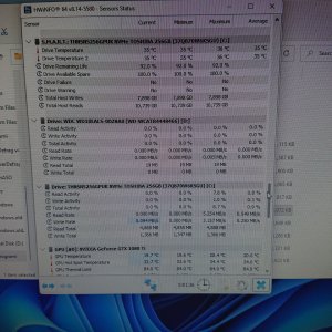

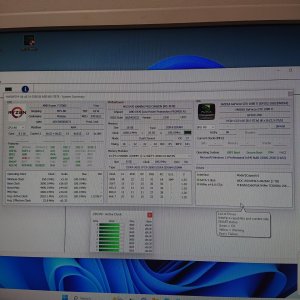

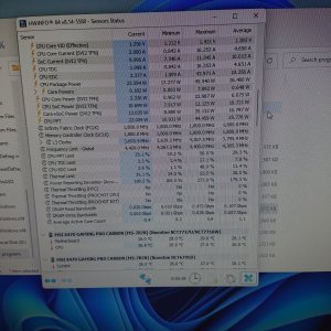

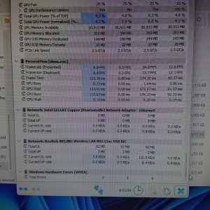

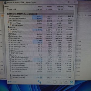

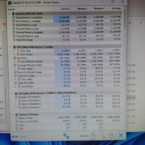

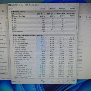

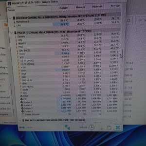

What kind of temps do you see on the GPU? Use something like hwinfo64 to check temps. You might just need to reapply thermal paste.
Reactions: Miki248
Thank you for the comment.
I tried using hwinfo64 a moment ago but it just stopped at "Detecting ATA/SCSI Drives..." and computer got frozen.
Miki248
Nov 23, 2024
11
36
Ok, I finally got the screen after being frozen for few minutes.
Here is the screenshot.

Miki248
Nov 23, 2024
11
36
I'm going from memory here. When you open the software a window should pop up. Check the sensors box.
I finally got it to load, here are the screenshots:

In2Photos
Mar 21, 2007
2,622
2,793
Well your temps at idle look fine so that's probably not the issue. As others said your GOU is probably the problem based on the symptoms you mentioned. Do you have any way to try a different GPU? Friends or family have one you could try?
Reactions: Miki248
