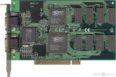

They should've kept updating SATA like USB. SATA ports are cheap and easy to be plentiful on a mobo. 2.5" is a solved problem for heat, and you can put it anywhere in a case with double-sided tape, including next to 120mm/140mm intake fans .
The vast, vast majority of users don't need NVMe bandwidth for storage. For those rare people that do, the SSDs should sit in PCIe slots like graphics cards.
A 15W Voodoo 1 doesn't even need a heatsink, much less a fan / liquid cooling that these latest 10W PCIe 5 monstrosities need.
