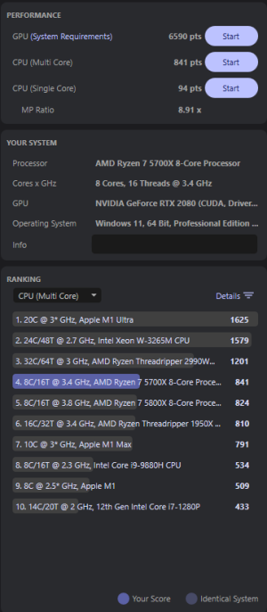

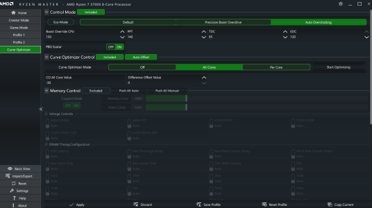

I was trying to play with Ryzen 5700X PBO setting
I would like to know, Am I at sweet spot ?
PPT=130 TDC=82 EDC=138
Curve Optimizer is Negative 30
I am using CINEBench R23
Thanks in advance

I can't say for sure, but that is a nice memory OC you seem to have going there. What memory are you using and what VDIMM are you applying?
As for the PBO tuning with the curve optimizer, a -30 offset seems very optimistic. I believe I am running -9 all core on my 5950X, though I believe my scalar is 2X. What are you using to test for stability? (Hint: you can use the p95 with corecycler, to test each core boosting for stability)

Here is my fine-tuned one.
PPT=140W TDC=90A EDC=150A
All Core have - 30
Scaler is 10 X
200 Mhz
All Core are as a cure optimizer Negative 30
Here is a Cine
I didn't O.C. I need 100 % stable and able to runs weeks non-Stop. :D
I am not sure, if I can further optimize ?
Any input is greatly appericated

You realize that tweaking with pbo2 can cause instability? It is basically a form of OC, especially with the +200 MHz. That is why you need to stress test

Yeah, you can run P95, or try core cycler, that can test individual cores and tell you which core fails, if any.

More likely your tweaks aren't stable. The CPU should throttle as it gets too hot, but you are basically undervolting to the max, so I am not surprised it crashed. I suppose if your temps are high though, that doesn't help either. What cooler do you have? And when checking the event viewer, are there any WHEA errors?

You could try setting a temperature limit a bit lower, like 85C or 82C or something. This should help keep the core temps from getting out of control during stress testing, gaming and any rendering work.
