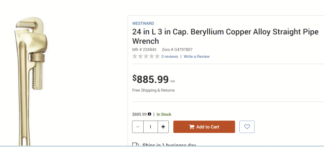

Have you ever checked out Zoro tools? It is owned by Grainger and cheaper. It was supposed to compete with the B2B websites. I have ordered things from there and they actually show up with the Grainger part number on the box. For instance, that wrench on Zoro is only $885. Just hope to save you a couple bucks in the future.
I use Zoro when the parts I need aren't time sensitive. Their prices are usually better than Grainger but the shipping times are longer and their inventory isn't as good. The reason Grainger is my go to for certain parts is because of their ability to get it to me next day.
This is just one example but I had an electric motor fail in one of the smaller greenhouses and I needed to get it back online ASAP. Without ventilation temperatures inside a greenhouse can easily reach over 120*F(48*C). Zoro was cheaper but needed 3-5 business days. Grainger had it in stock and to me next day.
This is my smallest greenhouse measuring in at 26' X 65'(8m X 20m)but it has around $20K in product so getting the ventilation fan up and running was worth the extra cost.

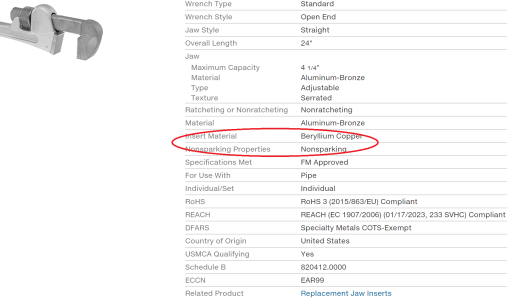

McMaster-Carr has a similar one for only $452. https://www.mcmaster.com/6498A5/ So, unless you need it's exact features, no it is not worth over $1k.
The materials are different. Aluminum Bronze isn't enough for ATEX Zone 0 or Zone 20, in which an explosive gas or dust is present continuously for long periods of time.
The one I posted has non-sparking, non-magnetic, beryllium copper jaws where it matters most (that is, where the tool is doing most of the work that might cause problems). Of course, like I stated, if you need the exact features such as all beryllium, get an all beryllium tool.
