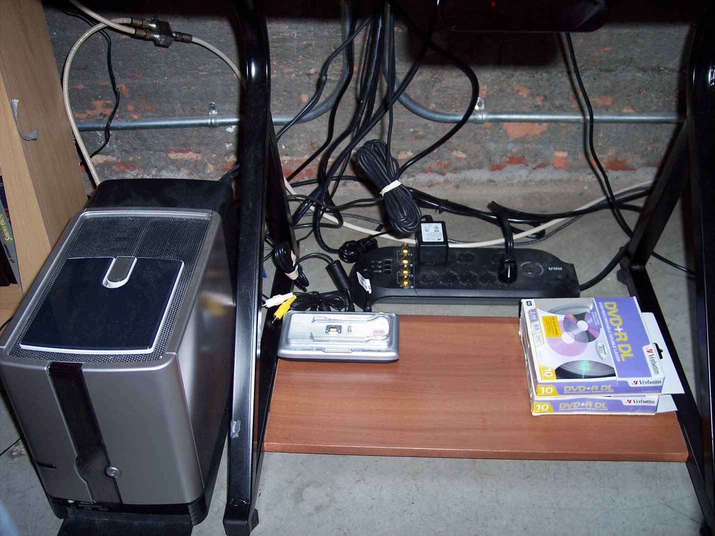

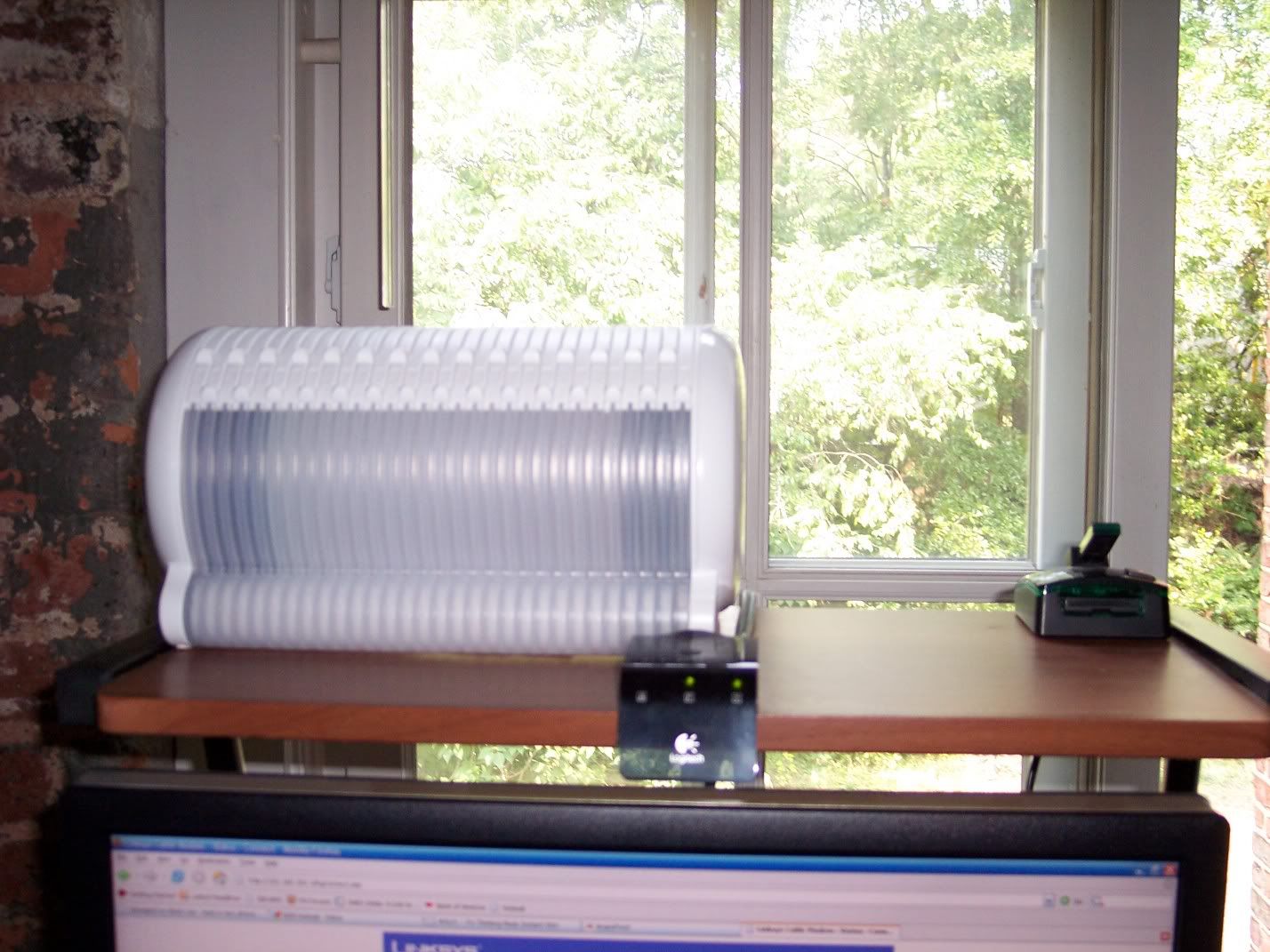

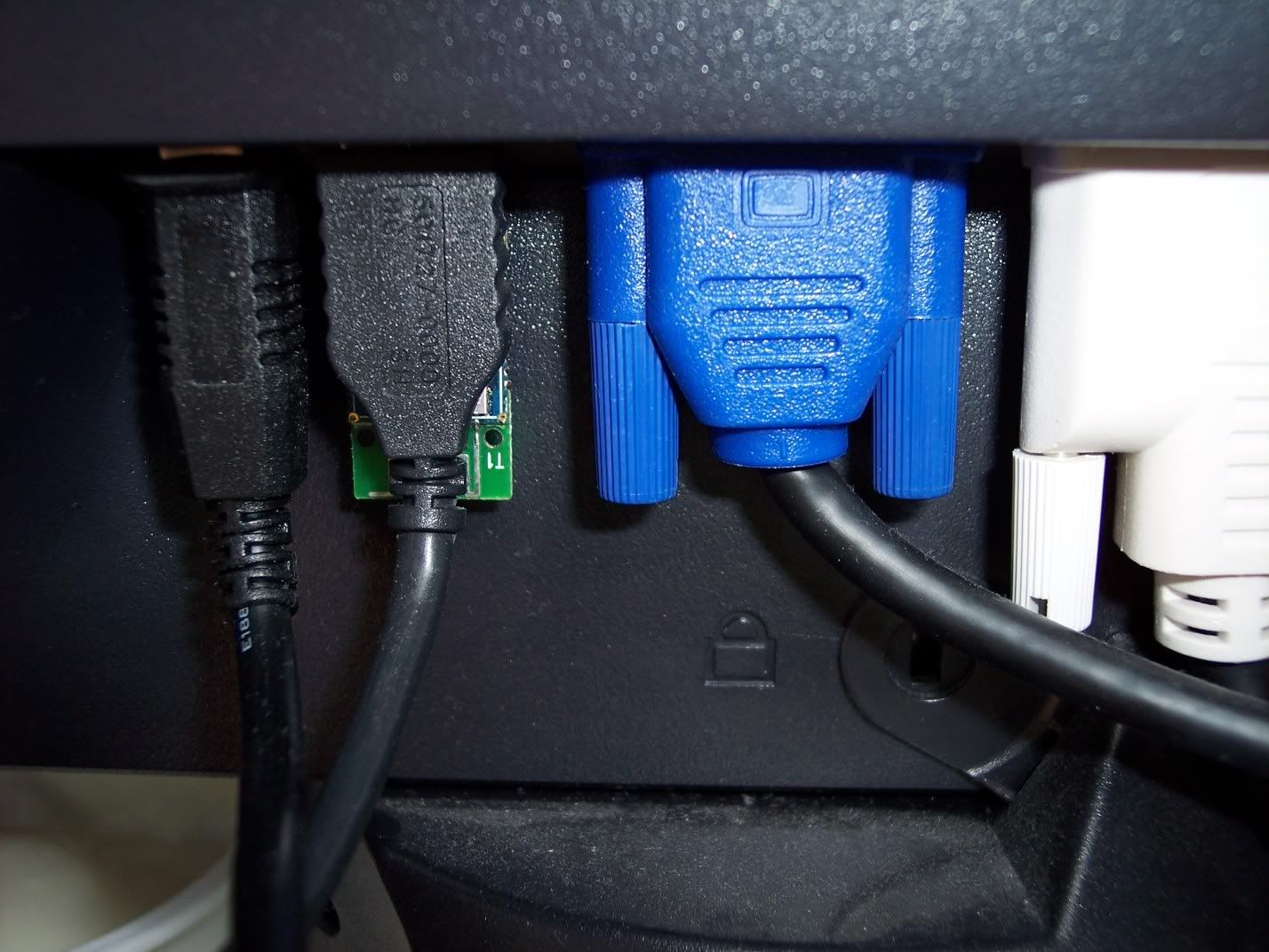

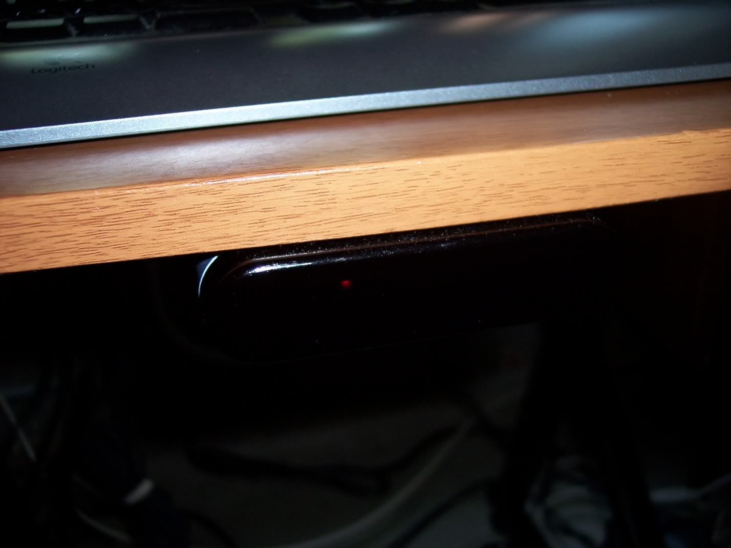

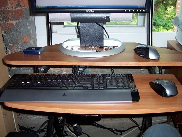

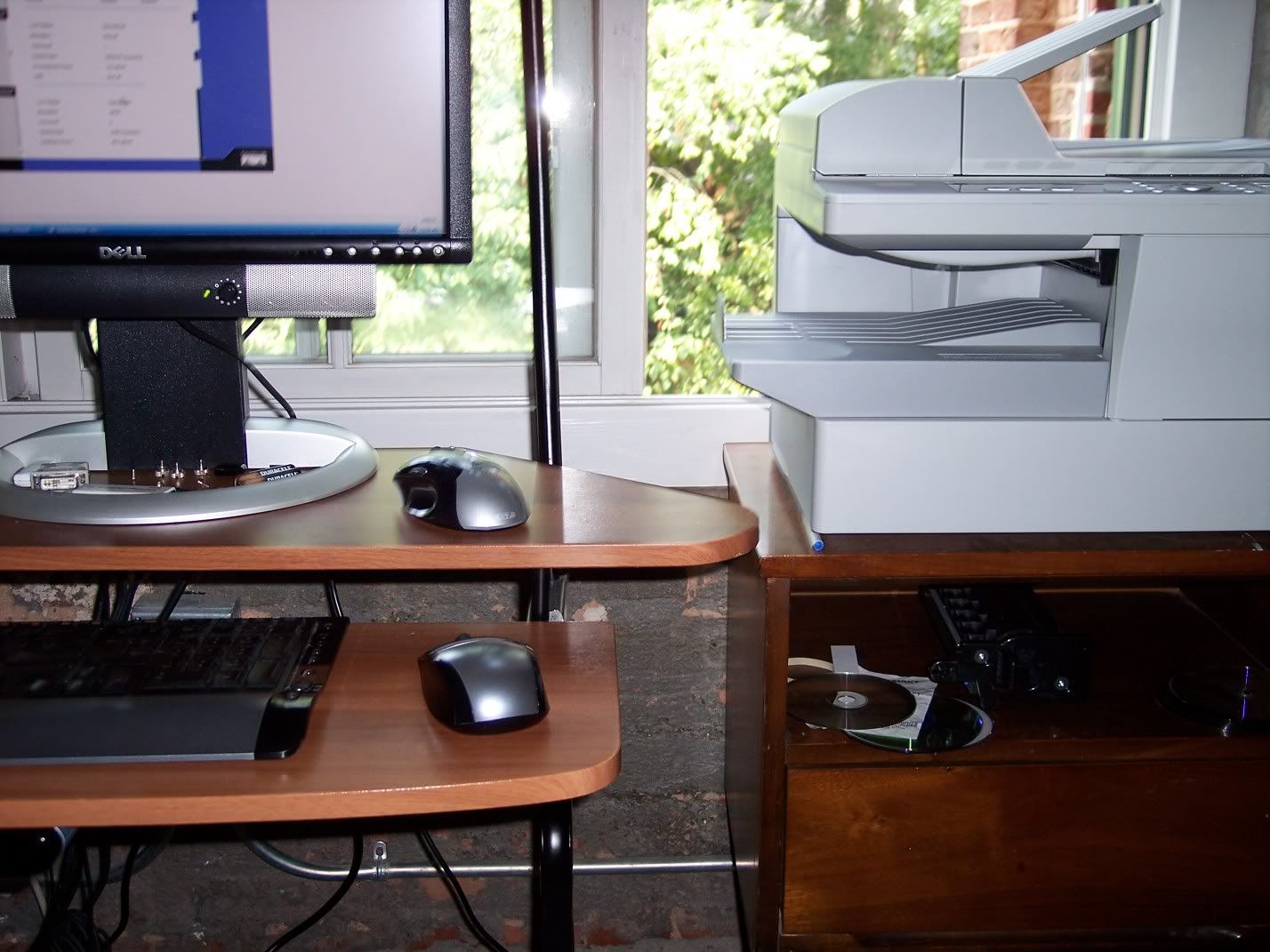

PICS:
keyboard, mouses, receivers, charger, IR receiver
camera dock
IR receiver
mouse and multi-function printer/scanner/copier
USB receiver and charger/receiver
G7 charger/receiver, bluetooth adapter The BT adapter is only the PCB because it was too fat with the plastic shell.
