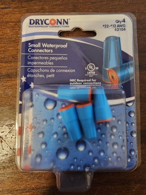

It is 16 gauge wire and a second look and, yes, this isn't a thick cable and should be an easy cut. Since I have no plan to add to these lights, a simple cut and cap is my plan. Can I just cut the wire without stripping it, and using something like this to cap it?

You can, but you shouldn't. It should be properly terminated with a cable end or in a junction box. Were talking about a few bucks and a half hours time, do it right.
In all reality, putting these on the unstripped wire ends and shoving the end in an outdoor box with a cord grip will be fine.
available at any hardware store individually.
