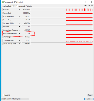

I just built a new PC (i7 13700 & Z790 Gigabyte Elite & 32 GB RAM) with an Arc A750. It is a 2 monitor setup - 2 BenQ monitors It is running driver version 31.0.101.4255
According to this TechPowerUp article the issue was fixed with an earlier driver 31.0.101.416.
Yet according to ArcControl it is drawing between 39-44 watts. It never dips below 38W.
I am not tech savvy, so am I reading the wrong reading? Or does GPU Core power measure something else?

You can look under the sensor tab in GPU-Z or use HWiNfo and see if the usage matches up with what the Intel app is reporting.

from the comments it looks like it isn't fixed for most multi monitor users.
