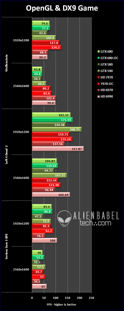

i was thinking a 570 not only has the full hardware scheduling, but also just as much theoretical performance. am i thinking correctly or incorrectly?
Instead of imagining things, it’s a better idea to search for the information given specs and benchmarks are publicly available.
Here's a piece I did that should be exactly what you’re looking for, given it includes a lot of older titles. I even listed the specs of the cards:
http://forums.anandtech.com/showthread.php?t=2239077
The difference between 580 -> 680 should be roughly comparable to the difference between 570 -> 670.
Apart from a few older games that are about the same performance (or a bit slower), the GTX680 is faster overall, and uses less power too.
But then we already knew Kepler is superior for games than Fermi for total performance, perf/mm2 and perf/watt metrics.
