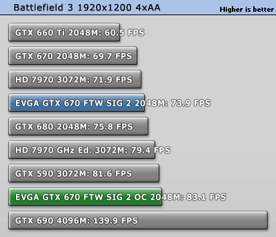

The 7950 cards with Boost are the same speed as a GTX 670 stock since they run at 950MHz. The cards without Boost run at 800MHz so they are slower.
That is looking at stock figures. Both overclocked to their max they'll still perform the same:
Most of the HD 7950s in the market right now have the Boost BIOS, so even if you're gonna be running at stock speeds, I'd recommend you save your money and go with that because even looking further ahead the HD 7950 should be a more "future-proof" card because it has more memory bandwidth and more VRAM.
