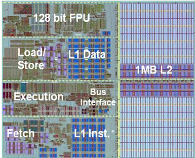

itsmydamnation
Feb 6, 2011
2,914
3,532
that post from SX really shows how much bigger the int core is on bulldozer comapred to STARS with 1/4 of the cache the core is 16% bigger. just eyeballing it it looks like -L1D BD int core is around 45% larger then a STARS core.
here is my bad at work eyeballing math :D
Llano 3.3mm sq
Llano L1D littel under a 1/3 of core size so 1mm sq
BD 3.84 mm sq
BD cache is about 1/2 the size of Llano L1D so 0.5mm
so 3.34/2.3=1.45
is there any more detailed analysis of the SB core then in that link?
IntelUser2000
Oct 14, 2003
8,686
3,786
It's critical you include the L1 caches in core measurements. That's how important they are to the function of a particular architecture.
So the correct core comparison is
Sandy Bridge: minus the L2
Bulldozer: minus the one "core"
K10: of course this is just the L1 included core
16.5mm2 vs. 15.6mm2 vs. 9.69mm2 respectively
Bobcat is not comparable because its not even on the same process generation.

i know, but you get an idea how much more logic there is in BD int core compared to STARS(that was my only point). its also interesting that even though BD L1D its about 1/2 the physical size of llano its only 1/4 of the size in bytes with higher latency but higher associativity. also is L1D in STARS exclusive to L2 ( i think it is).
As I wrote on twitter you have to be careful with mAJORD's Llano core area analysis since he didn't include some parts of the integer core:
At least the parts left and above "Exec" should be included as well.
