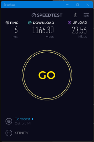

Only Move stuff when i unplug everything to do the 3 Month Dust clean out procedure. Then plug usually everything back into same Port.
Only Pain in the rear thing is getting the Wifi/Bluetooth Antennas properly reconnected so they don't flop all over the place, right now using the magnetic extension thing and got it as far as can away from rear of PC lol. but at least outta the way of the USB plugs this way
