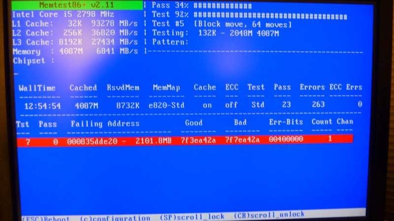

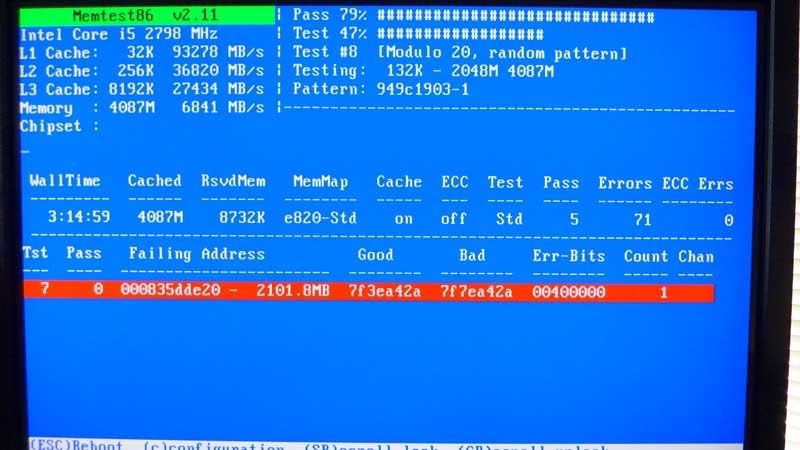

So I picked up the corei7 860 + Biostar T5XE combo at Fry's during black friday, and just got around to putting it together over this past weekend. I have some DDR3-1333 OCZ Platinum 4gb (2 x 2gb) to go with that as well.
So first off, I tested my ram using Biostar's built in Memtest86+. I seem to have an error with one (or both?) of the sticks:
Further testing showed:
At 3 hours
After leaving it on all day while I was at work
Seeing as how the failure occurred at 2101.8mb, does that mean the error is from my second stick, or is this something hard to tell? I suppose this is something I should get taken care of? This is the first time I've run memtest and I've read that just one error is bad. Am I to count this as 1 error or 263 errors? Guess it doesn't matter since I've got an error anyway... I need to contact the store I bought it from or OCZ...
