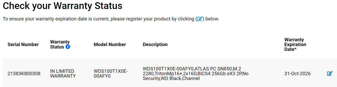

fzabkar
Jun 14, 2013
172
46
101
That's a good trick for deciding things.
I suspect that your WD SSD may be similarly encoded.
https://support-en.wd.com/app/warrantystatusweb
S/N -- 21383K800308 -> week 38 of 2021
Warranty Expiration Date -- 31-Oct-2026 -> 5 year warranty + 1 month
Model -- WDS100T1X0E-00AFY0
Description:
WDS100T1X0E-00AFY0​
ATLAS PC SN850​
M.2 2280​
TritonMp16+​
2x16D​
BiCS4 256Gb eX3 2P​
No Security​
WD Black,Channel​
This example is consistent with my suspicions:
https://thepcenthusiast.com/wp-content/uploads/2020/12/WD-Black-SN850-Gen4-SSD-Review-03.jpg
Reactions: Pentacore

https://www.google.com/search?q=A069010PF820001N&tbs=isz:m,itp:photo&tbm=isch
Even the warranty sticker is the same in many cases.
