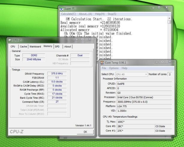

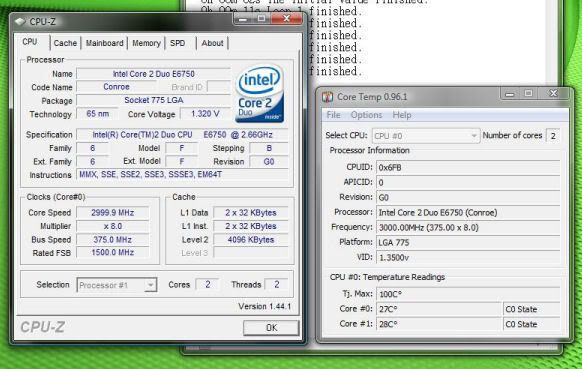

Update on progress:
I am now running stable @ 3.0gHz :) so its a great start.
To get beyond 1400 x8 I had to link the FSB and Memory and run in Sync mode, then I was able to quickly up the FSB adding a bit of voltage here and there. The details of this setup are:
Link in Sync mode
X8
1500 (375)
Memory timing: 5-5-5-17
Core Volts: 1.3500V
Memory: 1.95
NB: 1.35
VTT: 1.35
This has been stable for hours now of playing Crysis (testing :) ) Super-PI M8 and Prime95.
On load the cores are 32c so I was wondering if I should be able to increase things more?
Thanks for all the help so far I was wanting to get to 3.0gHz and call it a day but now I have the bug and want more :D
When I try to increase the FSB over 1500 even by 1510 its starts but hangs about 50% loading windows do I need to adjust so of my voltage levels first?
Are you sure Core Temp 0.96 reports CPU Cores at 32*C at load at 3.0ghz?
Download Intel Thermal Analysis Tool (ITAT) and see what that gives you:
http://www.techpowerup.com/downloads/392/mirrors.php
Ok so if you linked your memory to run in Sync with FSB that means for every increase in FSB memory speed changes. However, you told me that when you were running your FSB at 1400 (ie. 350 base x quad pumped) your memory was running at 400 (i.e. DDR2 800) This means FSB: Memory ratio of 350:400 => 7:8.
So it follows than that if you are running 375FSB now (1500 effective) and your memory is therefore running at ~428 (ie. DDR2 856). So now you are overclocking your memory as well which means either the memory or the cpu is holding you back.
At this point you can either:
1. Figure out how to set FSB to Memory ratio of 1:1 if you have that option. This way you can increase FSB to 400 (ie. 1600) and still run your ram at stock speeds and at lower timings (ie. DDR2 800 at 4-4-4-15 as opposed to 5-5-5-17 you are running now).
2. Increase the cpu voltage slightly from 1.35000V to 1.375 or 1.385 and see if you are able to go beyond 3.0ghz this way.
If neither #1 nor #2 solves your problem, then try both of them together and let me know how that goes.
Make sure to download CPU-Z so that way you can check
1. Actual voltage (since it wont match what you set in the BIOS). This is important since we'll be able to tell how more voltage is safe to add.
2. Memory speed and memory to FSB ratio. We'll need this to see if you are overstressing the ram so we can isolate it from the limiting component.

This is perfect! Ok see how you have FSB:Memory = 1:1 and DDR at 375 (ie. 375x2 = 750 effective). This means you still have room to overclock the FSB without overclocking the memory. So whatever settings you had when you took this screenshot, put those in the BIOS.
Therefore, it's not the memory holding you back. Since your cpu voltage is still 1.32V, there is room to increase it. Bump the CPU voltage in the BIOS to 1.375 like I said or 1.385 and see what CPUZ reports. You should be able to get to 400FSB from here with a slight voltage bump.
I am not sure why when you set it FSB:Mem to 1:1 the effective DDR2 rate gets so high. (maybe Nforce 6 chipset behaves differently from what I understand as 1:1) Perhaps, you should try 5:4 and 3:2 at stock speeds just to see what memory speed is in CPU Z. This will let you know what the memory speed will be if you set the FSB to 400.
Your temperatures are really good, but those seem to be taken at idle cpu load.
