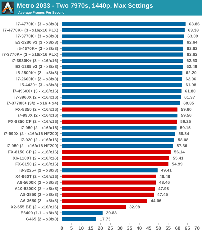

You have to compare at the resolution and graphics setting you're going to game, running a benchmark 1024*768 with medium setting is not going to reflect what the difference will be at 1920x1080 Max detail 4xMSAA.
This is closer to what he will actually see:
and adding a 2nd videocard:
So adding a 2nd videocard will increase fps by 80-90 percent, but getting a new CPU will increase fps by 10-20 percent.
