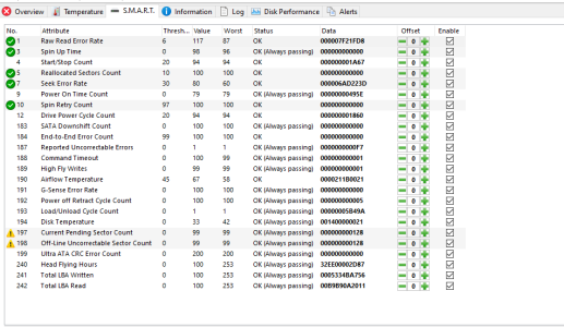

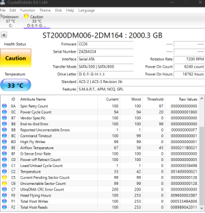

Hello,
Could you please see these results? Should I buy a new HDD now? I feel that the speed of the hard drive has decreased.
Thank you

The uncorrectable/pending sectors are a bad sign. If avoiding unexpected downtime is important to you, I would recommend replacing the drive as soon as convenient. If unexpected downtime isn't that big a deal, you could continue to run the drive until you hit a sufficient obstacle to reconsider your decision.
I'd suggest backing up your data but you should already be doing that regardless of this situation :)
Drive performance may have decreased if the drive is either encountering more problematic sectors or it's attempting to recover from the 'pending' sectors.

It looks bad. Look at Windows Event Viewer you should see a lot of errors.
I have a seagate laptop drive that's running almost 6 years and still good, another drive with the same model died almost 2 years earlier though,

Shut down the system with this HDD ASAP. The longer you run it, the more you increase the risk of it dying spectacularly. As others here have advised, backup important data, shut down the system unless you absolutely need it and buy a new HDD. Once everything is up and running, do a full surface scan of the old HDD, letting it fix any bad sectors. Then you can use it for storing data you don't care about losing, like ISOs or movies.
This ^
I would replace it asap.
It means your HDD is starting its downhill decent to a recycle center, and will get worse and worse.
If you haven't lost any data or corruption, i would start backing up ASAP and trying to pull what i can pull from that dying drive immediately.

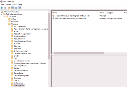

I dunno about that. I once "repaired" (swapped out an "old" 320GB factory-spec WD Caviar drive for a brand-new 1TB one), at the behest of Windows 7's built-in SMART support, that was reporting that the HDD was "Old age", essentially, and time to replace.
Win7 definitely does have built-in support.

some notification in the system tray
It appeared, from my observation, to be coming from Win7 "System", and prompted me, really, kind of walked me through the steps to use Windows System Image Backup to backup the OS Image/drive onto an external HDD that I supplied, and then also made a bootable DVD that I used after installing the new fresh 1TB HDD initially, to boot off of and restore from.
  • Love
13,301
7,901
Thanks! Learned something I never would have known!
This is disabled by default in Win10. I guess it comes turned on in Win7.

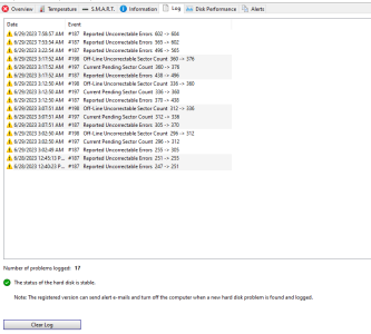

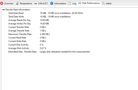

Shervan360
Sep 1, 2019
36
66

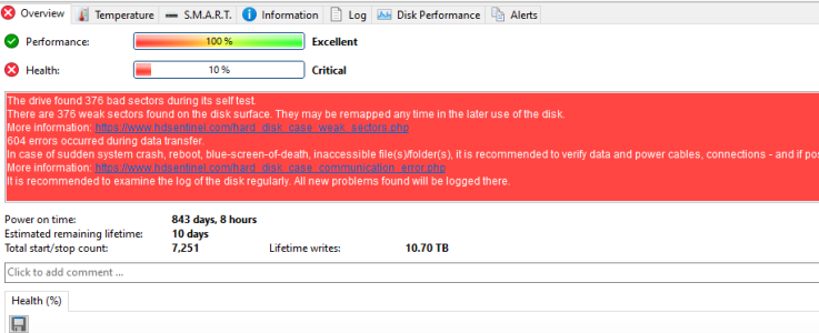

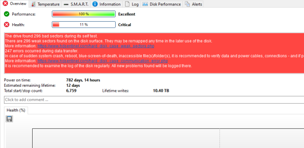

Hi again,
The situation is today.
Has the situation worsened?
mikeymikec
May 19, 2011
16,910
7,839
Hi again,
This situation is hard today
Whether it's continuing a steady downward trajectory or its descent is increasing in rate is hard to say.
In your OP you mentioned a decrease in performance. The other thing I would expect to have happened is that Windows becomes non-responsive for periods of time when it attempts to access the problematic drive and the drive is trying to handle bad sectors.
Other things that might happen:
1 - Windows crashes during start-up because of the problematic drive being connected (or takes such a long time to boot that you give up waiting).
2 - Your computer can't get past the BIOS POST stage (the on-screen stuff before Windows attempts to start) because it is trying to access the problematic drive and failing.
3 - Windows might boot but mark the drive as offline because it's had enough of it.
