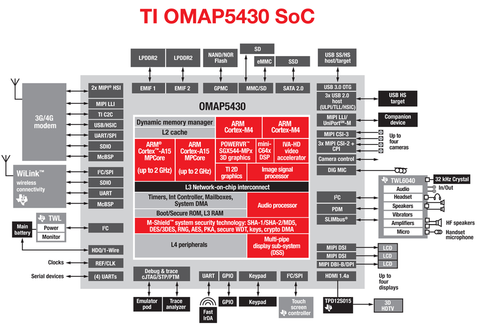

Pretty much, except a SoC is the entire motherboard in a single chip:
Everything inside the main box in the diagram is on the single SoC package.

A motherboard is a board that holds a lot of chips and ports and whatnot. Separate entities that work together.
A SoC is a single chip that encapsulates all the features of a motherboard into one unit.
Its kinda like...comparing a component stereo system to an all-in-one HTIB.
