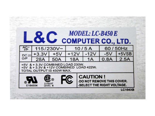

These days, most people that buy one of the 'generic' PSU's soon lives to regret it. I've seen generic PSU's die just after a year of service in a range of environments. I've seen quality PSU's last over 4 years in a range of environments as well. While you MIGHT get lucky with a generic PSU, you have a much better chance of having a name brand, known quality, PSU lasting for several years.
Personally, I wouldn't get a generic PSU, since the cost difference between the cheap-assed generic and quality is far less than what it would cost to replace the hardware killed by the generic PSU WHEN it fails (not if).
Also, the generic PSU's tend to be light on Amps on the 12V rails compared to quality units. Getting a 400+W PSU with less than 18A (or 22A) on the 12V rail is not a good idea. It also tells of how poor the quality really is when it can't deliver enough Amps to the line. Quality/branded PSU's also tend to have additional features that the generic's don't (another way they keep the cost down).
I tend to get PSU's from just a handful of makers that I've had good results from over the years. I also won't get a PSU from a company that hasn't been making them for at least a few years (rules out many of the newer PSU's coming into the market). I'll wait and see how they do over a 3-5 year time frame and see what they get for a reputation.

What akira said about the amps on the 12v rail is the usual reason people buy better ones, but also the whole "when the crappy PSU goes so does your 1000+ dollars in equipment" thing usually has a big role in it too.
