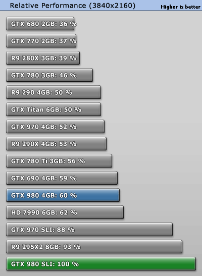

http://www.techspot.com/review/1033-gtx-980-ti-sli-r9-fury-x-crossfire/
Specifically, even though 980 SLI sounds decent at $740 vs. its $1100 launch price a year ago, compared to R9 295X2 or 970 SLI (in your case due to HDMI 2.0), it's still not that great of a purchase. Ignore the VRAM issue of 970 for a second and look at the FPS.
980 SLI is just 14% faster than 970 SLI. Some reviews show 16-17%.

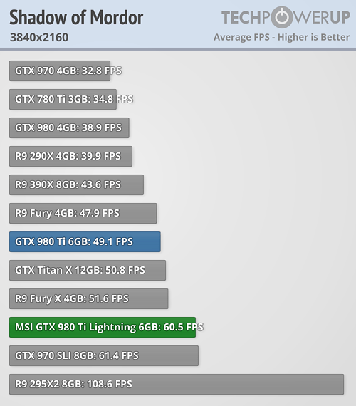

So do you think a OC'd 980Ti is good enough as a single card for 4k? I would look at the Gigabyte G1 model.
It honestly depends on the settings you use and what FPS you require. If we are talking about high quality settings at 60 fps, it's not enough but neither is the 980 SLI. Some of these benchmarks do not even include MSAA/SMAA or the highest settings (HairWorks, etc.).

I also disagree that 980 is good enough for 4K. In a lot of games you will need to drop settings to medium to get good fps on a 980 at 4K.
980 often gets dropped hard at 1440P in modern games. In some games you will still have crawling edges. Again, I don't want to get into pages of arguments. Based on countless reviews I read online, the general consensus is if going 4K, grab 980Ti SLI or Fury CF, no less.
As I said earlier, it depends on the game and where the game was benchmarked. For example, in Anno 2205, 980Ti gets almost 43 fps in the beginning of the game but by middle/end of the game, the # of inhabitants drop FPS to 23-26 only.
http://www.computerbase.de/2015-11/...viele-einwohner/#diagramm-anno-2205-3840-2160
Yet, if someone is playing Starcraft 2, 980Ti would be flying so it's difficult to answer without looking at specific games the OP plays.
