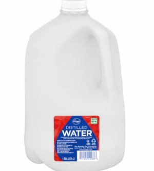

What do I need to look for when choosing a liquid for the system?
Are you going to use nickel plated blocks or copper?
If your going to use nickel you can go to a grocery store and buy a gallon of distilled.
Then i would recommend a type of biocide... like copper 2 sulfate.
You need a TINY bit... id say along the lines of 10mg or maybe 500mg for the entire 1 gallon jug.
Do not overdose, and keep it away from children and pets, as its very toxic.
Its called a biocide for a reason.
They used to sell a premixed bottle called PTNuke, but its no longer found.
But i use distilled, flush every 6 months, but i also use pure silver in my system.
You won't find silver coils, because of all the myths behind it, that completely ruined silver, not to mention a lot of fake silver got leaked into our hobby from China which contained iron, and well, i don't need to tell you how bad that ended up.
But since your using a distro block, you can't really throw in a silver mint bar, so silver may not be a choice for you. Also it doesn't play nice with Nickel.
