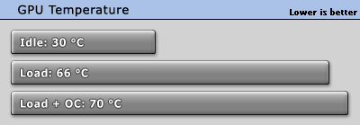

http://www.techpowerup.com/reviews/Powercolor/HD_5870_PCS_Plus/32.html
