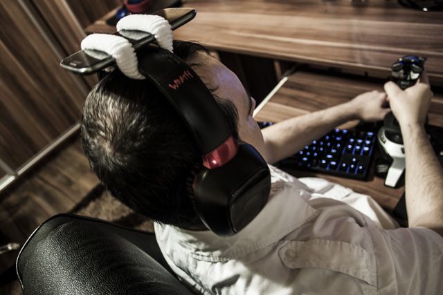

Recently purchased Xplane and I'm really digging it. I wanted get a head tracker but not the $150.00 commercial one so I am building a IR head tracker. Lost of folks of done it there are tons of videos online.
So what I spent to far.
PS3 camera from newegg $3 dollars
Camera driver PC driver $3
3 IR LEDs $3
Already had the resistors. but a couple dollars if you needs to purchase.
Head tracking software is free.
The LED head clip I'm making out of a balsaply . I'll just velcro or wire tie it to my head set.
Interesting I ordered the IR LED but got these huge ones. I tested them out and the camera sees them fine. So just 10 dollars and some time. When I finish my LED headphone clip I'll post and and some video of the action. Just do a search online for IR head tracker and there are tons of links on how to assemble.
Anyone else here make one and use it? what games or simulations are you using?

I look at it as another input device, can't have enough with simulators. Just curious have you tried a calibrated IR head tracking set up? I did and fell in love with it and I almost spent $150 which seemed a ripoff off and I saw all these other folks doing it for < 30 dollars.
Btw your movements are scaled, you don't have to turn your head 90% to end to look 90% you can set it up to whatever you want to. That why it's so valuable with only one monitor.
Anyway its up and running, still working on calibrating and here is a pic of my chepo-IRclip1000X. That and a 3 dollar ps3 cam and free opettrack software. btw you can play around with open track just with one IR or two led to do other things on your computer not just play games.
https://sourceforge.net/projects/opentrack.mirror/
Yea it looks like crap but its functional - maybe V2

Does your homemade version have 6DOF, or only 3?
I love how people here are bashing it without having tried it.
I've been using aTrackIR for a while now with latest IL-2 flight sim. Now that I have it, I couldn't imagine playing without it. It's vital for flight sims.
You don't actually move your head that much, it's very subtle. For moderate angles you don't even notice you're using it - it feels natural. Head tracking adds a tremendous amount of immersion.

6DOF, I'm still setting mine up on opentracker. yea the naysayers really aren't grasping the suttitley of how it works, or its benefits. While looking into it I see how popular it is in flying and driving simulators and some newer games such as on Elite Dangerous. Looks like a cool game going to try it out.
BTW what's really cool if you just want to play around with head tracking the opentracker software you can use your Smartphones Gyro as a input to control your game if you want to try head tracking since its free. Strap it to you hat and go! https://www.youtube.com/watch?v=fYyorc6A7vo :)
