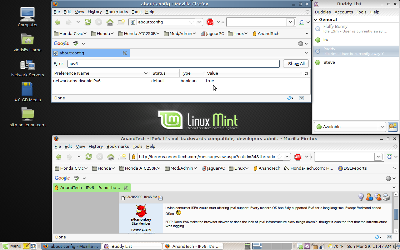

Yes, IPv6 makes your browser slower - laggy at best - unbelievably slow at worst. It's one of those 'all depends' situations...
If you don't know what IPv6 is (most ppl don't) you don't need it. Disable IPv6!!
If you know what it is (some ppl do) but don't need it, disable IPv6!
All I use is Firefox. Disabling IPv6 is super simple in Firefox - and it WILL make Firefox faster and more responsive!
Here's a screenie I just took: http://VinDSL.com/images/HowTO_Disable_IPv6.png
Go to 'about:config' filter for 'ipv6' and double-click to disable [value=true]. You'll need to restart Firefox for this change to take effect.
Simple pimple! :D

How does it slow down the browser?
Google is your friend! :D
http://www.google.com/search?&q=firefox%2Bslow%2Bipv6 (Google Search: firefox+slow+ipv6)
Take your pick...
Examples:
I was about to write a post about how Intel?s Atom processor wasn?t quite fast enough to run Firefox 3. It used to be painfully slow on my netbook, until I found this great little trick. Apparently, Firefox grinds to a halt while trying to find ipv6 internet addresses that are unavailable on most networks.
When developing on Vista (or XP with IPv6) you'll notice that Firefox is extremely slow on localhost-sites. Here's a fix, courtesy of Dan Wahlin's Weblog, via ScottGu's blog.
In Firefox, type about:config and then in the filter box type dns. You'll see an entry named network.dns.disableIPv6...
Double-click that line so that it reads True, effectively disabling IPv6.
I have just installed 11.1 on a few machines , all upgrades from 11.0 , it may just be something stupid I have done but I find firefox tediously slow on 11.1. There seems to be a delay when opening web pages, like its taking ages to resolve DNS. I have set all DNS manually. When I do a back to back with a 11.0 machine or even a Windowz machine the 11.1 is endless compared. This is not confined to one machine it seems to follow 11.1 around.
Anyone have any Ideas ?
I was having the same issues with firefox...it seemed hopelessly slow, but disabling ipv6 worked like a charm.
Now that 'they' have admitted IPv6 is incompatible with IPv4...
My theory (WHY this happens) is IPv6 confuses the DNS lookup process. That's why, for instance, you'll do a Google Search, but your browser can't find Google - it gives you an error message and tells you to try again. Or, it takes forever to 'draw' a web page that includes/sucks content from lot of different sources - your browser has to resolve/lookup all those IPs, and IPv6 is screwing the pooch.
All I can tell you is, 'they' had better get their sh!t together. IPv4 addresses are going to be exhausted soon (2010-2011) and 'they' better make IPv6 compatible with IPv4 or all hell is going to break loose!
BTW, this is NOT (strictly) a Firefox issue! This IPv6 vs IPv4 incompatibility issue exists across-the-board.
It's probably the single greatest mistake in computer history! ;)
That was known from the start, this is nothing new...
Only if your machine has an IPv6 address configured and technically that's a local config problem if it does but it doesn't work. If you don't have an IPv6 address configured your web browser won't be able to try and will immediately fall back to IPv4.
We've been hearing that for at least a decade now...

These all seem like infrastructure issues (no IPv6 available, so it times out), not IPv6 making the browser slow. Do you have any evidence of IPv6 causing the browsers to be slow or just anecdotal evidence in environments where there is no IPv6 available in the first place?
I don't think the incompatibilities are the problem, it's the lack of acceptance. Which could possibly be chalked up to the incompatibilities I guess...
