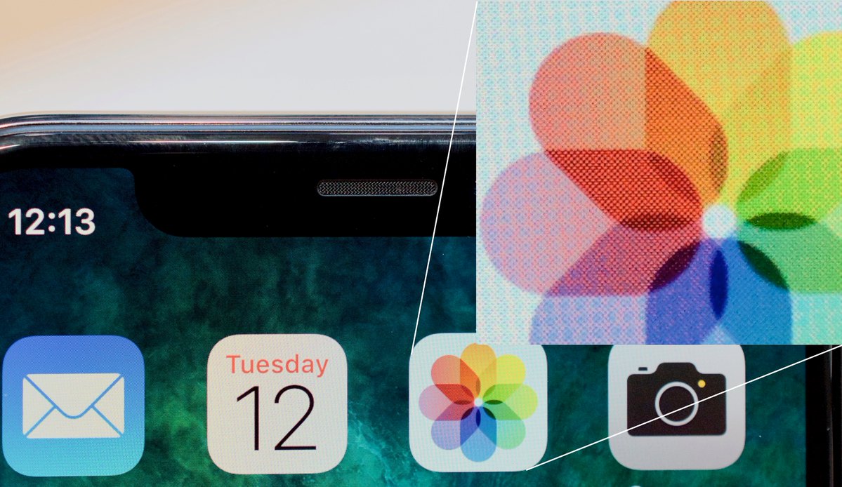

Presented as it is for whatever it's worth. As a reminder, a diamond matrix pentile screen means that of the iPhone X's 450PPI, the red and blue colour channels actually have 2/3rds of that, ending up at resolving power closer to the base 8, rather than 400PPI Plus. The green channel, where people can see more detail with our eyeballs, does have the advertised resolution. Pentile also has nonlinear arrangement problems.

I think I'm in the 99%. What features am I supposed to be looking for in the images above? To me they both look the same and both look ok.
I think the OP put the same two images, that or we need microscopic implants to get better than 20/20 vision!

Very strange debate. Of course they're the same, they're clearly duplicates, i.e both have a earpiece/camera cutout, i.e both are iPhone X's...
The OP just made a mistake and posted the image twice, no need to spend any time comparing them. He's just showing the diamond pentile matrix using a macro shot, and a zoomed out regular shot to give context.
