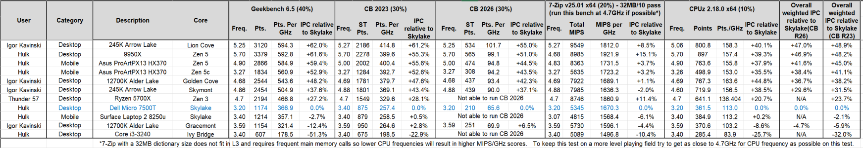

Here is my take on determining "throughput/cycle" for the purpose of comparing CPUs and their supporting memory systems. Full explantion in the secon post of this thread.
Also, it is understand that these benchmarks don't simply test compute. New processors have the advantage not only of better architectures, but also better memory subsystems to feed the cores, as well as new ISA instructions that may be used in the benchmarks. It's all folded in.
Data summary is presented in the first table. "Performance Points" are baed on a total possible score of "100." A processor would have to be tops in throughput/GHz in every category to reach that score. Supporting data is in the bottom table and comparion of cores in the table on the right.
Thanks to Igor Kavinski and Thunder 57 for their time in gathering accurate data.

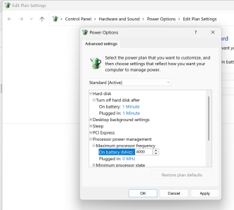

Setting Max Frequency for non-hybrid CPUs using Window Power Plan
If you have a non-hybrid CPU then a simple registry tweak will allow you to set a max frequency. Set it below a frequency no throttling will occur and Windows will hold that frequency. Of course double-check that with HWinfo.
This file when run will add the needed registry key: https://www.dropbox.com/scl/fi/bigm...ey=jnyrsz7g9bq7nhlb5elx7jwcu&st=kub4nlh6&dl=0
This is where you set a max frequency.

The benchmark results were compiled into a table for comparison. To enable cross-architecture evaluation, all benchmark scores were normalized relative to the Intel Skylake core, which was used as the baseline reference. Each benchmark score was first converted to a throughput-per-cycle value and then expressed as a ratio relative to the Skylake baseline.
The normalized results were combined into a single composite score using a weighted geometric mean. The weighting applied to each benchmark was as follows:
  • Geekbench 6.5 – 40%
  • Cinebench 2026 or/and R23 – 30%
  • 7-Zip – 20%
  • CPU-Z – 10%
These weightings were selected to balance general-purpose application behavior, sustained floating-point performance, and integer-focused execution characteristics while preventing any single benchmark from disproportionately influencing the final composite score.

Sorry, this investigation is limited to x86 architecture and ST throughput/cycle. As Thunder 57 wrote, I'm having a hard enough time getting x86 volunteers! I'm okay with this actually. This is a long-term investigation. I'd rather build the results slowly, carefully, and accurately than have a flood of nutty results.

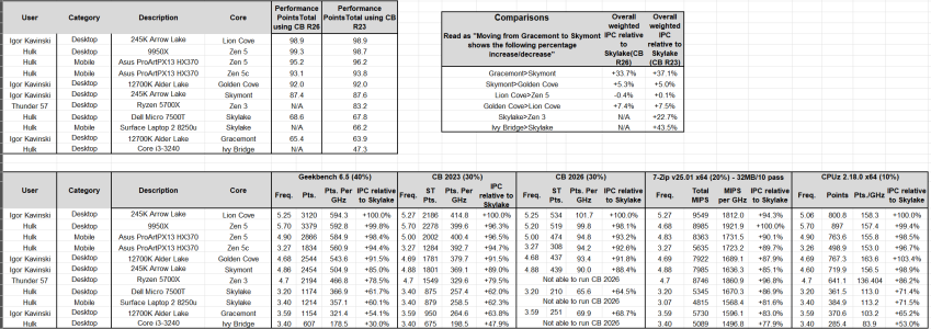

I think the results so far are very interesting and I would "hang my hat" on them.
Lion Cove ~ Zen 5
Lion Cove>Raptor Cove, +7.5%
Skymont>Gracemont (Alder Lake), +35%
Golden Cove>Skymont, +5%
Gracemont (Alder Lake)>Skylake, +5.5%
So at the end of the day Lion Cove and Zen 5 are quite comparable and trade blows in different applications.
Lion Cove is a relatively small but significant upgrade from Raptor Cove (except for gaming).
Alder Lake Gracemont is not as performant as Skylake, but about 5% behind.
Skymont is not as performant as Golden Cove, again about 5% less, like Gracemont and Skylake.
Skymont is a massive leap from Gracemont, showing +35% average increase/cycle in work.
These are numbers we kind of knew in our "gut" but couldn't put good evidence behind. These results were recorded very carefully and consistently as I was in contact with the benchmarkers and we made sure we performed the tests the exact same way.
Now you can argue with my weighting and choice of benchmarks of course, but this is just one limited investigation so take from it what you will but I think the results so far are very honest with not crazy outliers we often see in such tables.

I changed the comparison of performance to a max performance score of 100. In order to score 100 a processor would have to be the best in all four categories. This method is better than using Skylake as a baseline because it's easier to make comparisons between various CPU's in the table.
Yes, this is not IPC as I noted a few times both in the first post and the second. This is throughput/cycle, or work/cyle, or work rate. It takes more into account than simply architecture such as cache and memory subsystem, ISA, etc..
The results are accurate and align very well with what we've seen and heard regarding the processors. Having compiled the table myself and worked hand-in-hand with the contributors I have much confidence in the results.
But, at the end of the day all I can tell you is how the data was collected and the numbers. You can take it from there.
