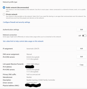

This has been going on for several months and I can't figure out what it going on. I'm connected via the Ethernet on my motherboard to our Xfinity router. Everything will be working fine, then it will just say that it can't connect to a certain page. This happens in Chrome and Firefox, and I opened Edge and that didn't work either. When I check Network Connections, it says the network connection is active and shows that data is being uploaded and downloaded. I've also switched to a USB wi-fi adapter and sometimes that will work for a while and sometimes not.
If I another program that connects to the internet, such as Steam, it will work, which really confuses me. All the other devices in the house will still work over wi-fi. A lot of times, if I restart my PC, the internet will start working again at least for a little while. Sometimes only for a couple of minutes. Then it will randomly start working again with no problems for a couple hours or days, etc.
I have run scans that didn't find any malware, and I've tried to reduce all the startup programs to only what I need and recognize.
I've recently tried turning off ipv6 and using manual ipv4 settings to use encrypted. I found an option to turn off DNS in Chrome which has had mixed results. Has only been a day or so with that. Below is a screen shot of my network settings. (I blacked out a couple of things but not really sure if those are sensitive info or not). Please let me know if there is any more info I can provide. This is driving me crazy and I can't figure out what is happening. Why would it just stop working for an hour then all of a sudden remember how to connect to the internet?! Thanks!

Using the motherboard NIC? Dur...finished reading the screenshot. Realtek 2.5gb ports are notoriously wonky. (as bad or worse than the Intel i225/226)

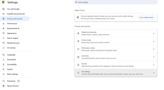

The amount of Junk that Chrome stores is Beyond normal imagination.
Try periodically to clear the Saved Data, Go the the Menu, set it acoording to the variables that you need to Keep (like passwords etc.), and clean.
