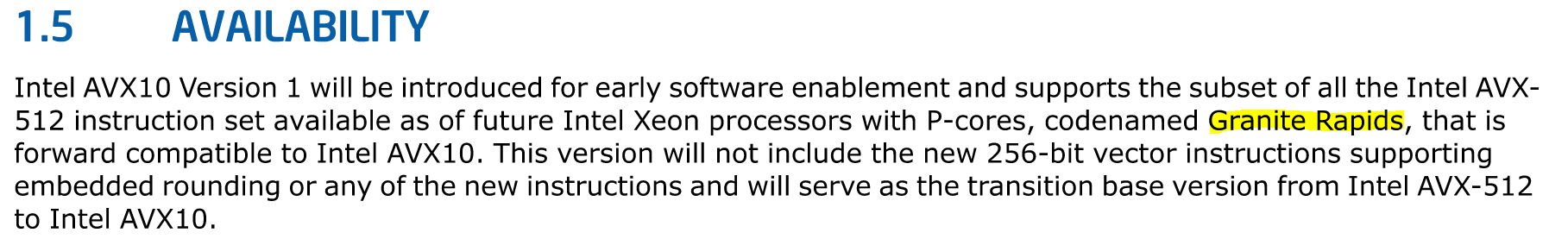

Saylick
Sep 10, 2012
2,861
5,646
AVX10 is what should have gone into ADL. All in all all steps into the right directions. Now I just wonder how long they all take before appearing in purchasable products.
AVX10 support is coming with Meteor Lake or Arrow Lake?
Someone on Twitter suggested that Granite Rapids would support it, which I think corresponds to Arrow Lake on the client side.
EDIT: Here we go.
Looks like we don't get AVX10.2 until the product after, though. Granite Rapids will be a transitionary step, so my guess is we don't get AVX10.2 until 2025 at the earliest.
EDIT2: Looks like I jumped the gun earlier. AVX10.1 is for Xeon P-cores only in the form of Granite Rapids. Given that it is AVX10.2 that supports P and E-cores, I now suspect that's the form we'll see it in the client space. Given that Granite Rapids and Arrow Lake are both 2024 products, AVX10 in any form likely won't show up in the client space until 2025?
