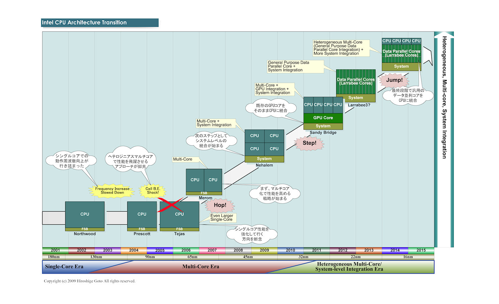

There is speculation of sorts along the lines of thinking that Haswell or the next architecture (the tock after 14nm Rockwell's tick) will be some manner of a heterogenous architecture with a bevy of these little cores present to handle the exceedingly well-threaded applications (like VM and so on).
You can always trust Hiroshige Goto for insightful, albeit speculative and cutting edge, CPU roadmaps and diagrams that no one else seems to be able to deliver. I'm impressed (pun somewhat intended).
