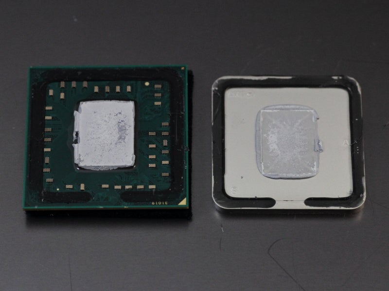

AMD uses the same "inferiour" paste TIM on all FMx CPUs.
Trinity and Richland delidded.

The TIM Intel uses is actually quite good; it's just not as good as solder.
The TIM isn't the issue, it's the imprecision of the application of that black sealant. Some its fine, others it creates an air gap between the TIM and the IHS.
