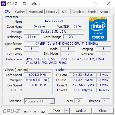

Thanks for posting. That's massive for Celeron, Pentium, Core i3 and locked Core i5/i7 users, a good incentive to upgrade to Skylake. Looks like the Pre-Sandy Bridge era of Intel budget overclocking is (unofficially) back. :)
It looks like the Saga of the Unlocked BCLK is coming to a bursting conclusion with both ASUS and ASRock enabling overclocking the base clock frequency of non-K Skylake processors. From the looks of it, a simple BIOS trick will enable the overclocking capabilities.
We will update this news article with the links to the BIOSes enabling the BCLK overclocking when they appear on the web. Until then, have a drool over Elmor's 5.8 GHz Core i3 6300 or L0ud_sil3nc3's 4.9 GHz Cinebench R15.
Update #1: Elmor posted a bit more details on the unlocking in the forum. For now the BCLK unlocking is in experimental stage with most obvious drawbacks being the lack of power management functionality and some benchmarks like XTU not working properly. The BIOSes will arrive in the coming days as more fin-tuning is required.

AnandTech has a story on overclocking locked Skylake CPUs too:
http://www.anandtech.com/show/9848/bclk-overclocking-intels-non-k-skylake-processors-coming-soon
What's also interesting is that there does not seem to be a need for motherboards with the Z170 chipset normally required for overclocking. E.g. the cheaper H170 chipset can be used too.
The massive frequency jump from 3.8 Ghz to 5.8 GHz on the i3-6300 was done under extreme conditions though (liquid nitrogen cooling and such). With standard air cooling more modest gains should be expected.

Very interesting! It's sad that the iGPU disables itself unless you do not use the Intel drivers for it once the bclk is overclocked. Those with dGPUs won't mind so much.
Yes, that's not so good for those using the iGPU. Where did you read this (I did not find it mentioned in the AT article)? No workaround available?

The Xeon E3 chips are available for reasonable prices (ie. 4c/8t E3-1230 v5 for $275). I wonder if those will overclock as well?

Screw Core i3, Pentiums will likely assasinate the budget market to AMD.
To make it better, if that is true... RIP unlocked Core i5 and i7. Or even more... if that is true, that means that Xeons will get a big benefit.
It will remain to be seen what's possible. If you could get an i5-6400 up to 4.5GHz, it would really eat into 6600k sales given the $185 vs $275 price difference. 4.5GHz is trivial on the 6600k though, that large a BCLK OC might be challenging.Considering the price difference between the 6700 and 6700k, I don't imagine that sales of the unlocked i7 will be terribly affected.
The Xeons are way more interesting, since you can pick up a 4C 8T E3-1230 V5 for $260, which is less than the i5-6600k. If it is relatively easy to pop that CPU up to 4.5GHz, it would be a pretty good value.

I think the locked i5s would be hurt most of all by widespread i3 overclocking. 6600K will still have its place.

I think the cheapest Celerons, 4C/8T Xeons, Core i3 6100, Core i5 6400 will benefit the most.

Core i3-6100 could become really successful. Looking at Eurogamer and other reviews this little chip is close to FX6300 MT performance at stock and destroys any AMD CPU in terms of per core performance. Jagat previewed what it is capable of with a mild overclock:
At 4.7-4.8GHz on air it will be close to locked Skylake Core i5 level of MT performance.
I don't agree that it will hurt Core i5 sales though. People interested in a 4C/4T CPU will still get one, especially if Core i5-6400 overclocks like its cheaper siblings.
At $250 a 3.4GHz (3.8GHz) 4C/8T Xeon E3-1230 v5 could potentially deliver OCed Core i7-6700K performance (or close to) for $100 less (even more if you choose a cheaper non-Z170 MB).

Sweepr, completely agree. It is now much easier to recommend an i3-6100 (and even the Pentium/Celeron chips) to gamers on budgets if overclocking is part of the mix.
Hope they don't nerf this...
