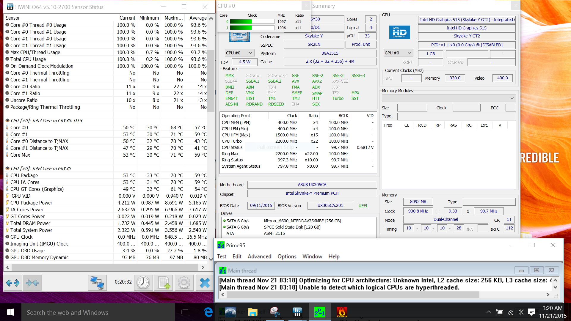

How do you know Prime 95 isn't running?
Because there s no P95 logo on the task bar.
Here the pic :
Another review s P95 test :
NBC reviews are paid review for most of them, a few firms have some requirements that are respected like Dell refusing to have power consumption displayed, Apple got their imac PSU completely cancelled from the review because power drain was 45W with a 45W PSU delivered.
There s also shills at NBC, apparently the one who rigged a Toshiba Carrizo-L laptop review was kicked out of NBC due to his blatant shilling that got them being refused the next deliveries by Toshiba.

If you're running Prime95 and you close the window, it minimizes to the system tray without a taskbar logo while still running.
lol, what an imagination...
If you close the window you ll also close the worker and P95 as well, i just tested it, not that i did believe your assumption but i wanted to check that you didnt even try to check by yourself...
ShintaiDK
Apr 22, 2012
20,378
145

As always you have no clue what you talk about.
It s you who have no clue, if the worker is closed the computation is stopped even if you have P95 opened, when the computation occur you ll automaticaly have the logo on the task bar since the worker is open in this case.
Do some tests rather than running after excuses, i posted two pics and the second one is what must be displayed when the worker is activated.

Honestly, I can't even figure out the point to your line of attack. Let's say prime 95 isn't running, so what? Clearly something is running that has the processor pegged and the igpu idle. And whether that something is prime 95 or the unicorn fart simulator, isn't pegging the cpu the point of the test? What is the point of your ridiculous conspiracy?
Conspiracy..??.lol, i guess that you have no argument, hence this ridiculous straw of yours.
If you did look at the other stress tests you ll see that the max power is exactly the same with 3 decimals, that s 30.263W..
Isnt it extraordinary that the system consume exactly the same max power with such a precison in two different tests..?..
A hint, they just recycled the other windows.
The worker is still active, hence heavy CPU load.

The chevron to the left of the notification area in the disputed screencap indicates that some notifications are hidden.
No, it definitely does.
If you have Windows auto-hide system tray icons, it can be disturbingly easy to accidentally leave P95 stress test running on your computer for a weekend. :p
