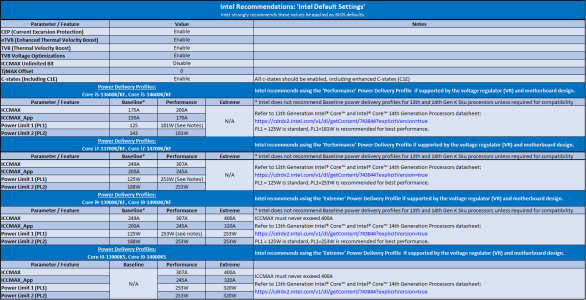

I recently upgraded a 12700 to a 14900 non-K. Is there any news on the non-k chips being degraded? For a couple of months I ran a 300W / 280 custom setting, but my workload was pretty medium most of the time. After some consideration I set it to 125W put the performance was terrible, so I settled on 250W for the moment, is this likely to be safe?

Maybe. Until Intel informs us all exactly what is going on, noone can really answer your question.
Anecdotal stuff here - but a guy on reddit said that he got rid of his stability issues at the 200W mark. What worked for one user may not work for others. But if you want to play is safe until Intel spills the beans I would screw down the wattage to the 200W mark.
We don't know the cause of the apparent degradation, so we can't establish a "safe" profile. However, there are things you can do to make sure the CPU is operating within the limits recommended by Intel. Start by updating your BIOS and then check all the settings below to make sure motherboard is configured properly.
You can use the values in the "Performance" column for a 250W configuration, but you need to make sure the current limits are also enforced (ICCMAX). Also make sure that CEP, eTVB, TVB and TVB Voltage Optimizations are enabled. The last few settings are essential for making sure the CPU uses less voltage under light loads.

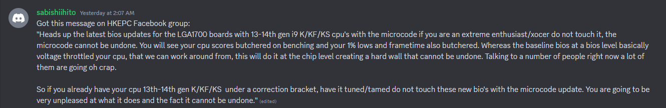

Install the latest BIOS, even if it's beta and hope for the best.
Just saw this on the hwbot discord
Latest rumors also kinda points to its the ringbus on raptor lake thats failing, something which would also explain that its a random core (P/E) and/or memory controller etc the error log points to..
voltage tolerance for the ring clock did not translate with the jump from 12th to 13th gen
The ring got bigger due to more cores and more cache
Alongside more baseline voltage
zir_blazer
Jun 6, 2013
1,265
586
What the hell does he means with "Microcode can't be undone"? Microcode is uploaded to Processor by Firmware about POST time (Nowadays can also be done by early OS boot) and goes in a sort of volatile patch RAM. It is not some kind of internal NVRAM.
UNLESS Microcode is blowing some kind of eFuses...
What I do recall is some kind of bug involving Intel XTU tool where changing the Uncore/Cache was sorta permanent and required a full Firmware reflash, since settings are stored in NVRAM but the Firmware itself doesn't clear whatever setting XTU was changing. There were multiple reports about that one, and I have memories of having personally encountering it.
I guess that is one way to deal with this situation. Just keep getting RMA's if you need it. Keep those benching scores intact... for as long as you can. But if performance is radically altered, Intel is leaving themselves open to a class action.
I just want to say, as someone who has tried to enable XMP and then still reign in Intel chips with power limits and all the rest for the last five or so generations, all this hoop jumping is ridiculous. Given how UEFI interfaces use their own lingo (side eye at ASUS) to further obfuscate this stuff, its felt darn near impossible. Intel not only pushed their chips too hard it seems, they let OEM's cook how their CPUs are configured for way too long. IMO.
Usually I can find the power limits and I set them to the ARK limits so like 125W long limit and 190W or whatever short limit with an actual time limit set. Now, without hitting all the bogeys does it even kick in? I used to install the Intel overclocking utilities, load up some distributed computing projects and make sure it honored both the limit and time limit as well. Too much work to verify settings though IMO.
If not set by default, there should be a clear "Enable Intel Configuration Baseline" or something as a box to check that should work along side of XMP for a quick double tap in the UEFI and continue on with your day.
Maybe AMD does the same thing, I dunno, but I've never felt I had to fight it that hard. Enabling the California & ERP (?) power compliance features seem to really tie it down quick.
