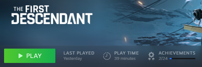

I can confirm that The First Descendant thrashes your CPU on shader compilation (and also decently during game). Despite having overkill water cooling on my 7800X3D it will briefly send fans full blast and hit 77°C.
I have however had 0 crashes. Unlike the author in the article who had 7 in less playtime.
The irony that the beta for this game ran ok for me several months ago on a 4790k. The minimum is a ivy bridge i5 and a fx-8350.
