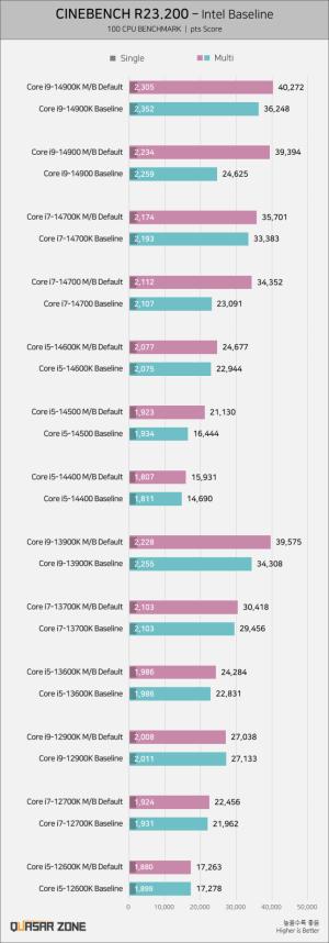

Korean reviewer Quasarzone tested baseline with models across 12-14th gen i5-i7-i9, and results are painful, non-k SKUs got hammered badly:
BIOSTAR is the first manufacturer that set baseline as default, while ASUS/Gigabyte didn't, and they also didn't recommend users turn on baseline if you don't encounter any stability problem.
What is shocking is, Asrock has already known this since last year.
It seems ASRock has joined this practice as early as 2023, and I just learnt about it. Here is another example (click here), readers can pay attention to the BIOS version and the corresponding official release date, so ASRock has known about it for a long time!
MSI and other vendors didn't mentioned whether users should turn on baseline or not, when stability issue occurs.
BIOSTAR's baseline seems still has very high ICCMAX, so the performance decline is not as big as Gigabyte's

Yikes. 33% or more of a drop for the 14900 and 14700 are ridiculous. I don't even think that the performance drop was anywhere near this bad for the spectre/meltdown mitigations.
I think most people here go with the K models which aren't hit anywhere near as bad, but the 14900 losing almost 40% is just bonkers.
Also it's within the margin or error so probably meaningless, but the 12900K actually gained performance with the baseline. Alder Lake stronk!
