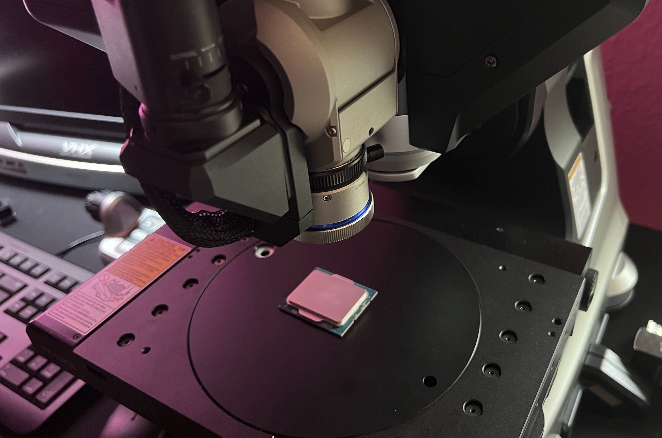

Igor's not mincing any words.
Calls it the Ryzen effect (i.e. Intel panicking):
In the video - for those who understand German and don't get dizzy listening to him - he basically thinks any CPUs which no longer can keep their previous frequencies even after "just" running "stock" are basically broken and on their last legs.
