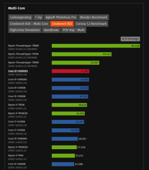

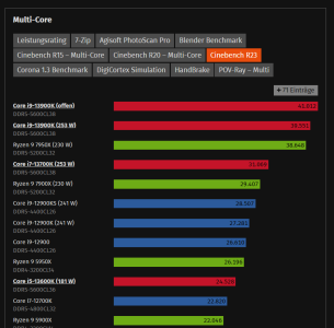

Abwx
Apr 2, 2011
11,991
4,948
Looks like Intel issued a statement on the situation:
In Computerbase review they didnt specify that the 14900KS was set at 253W contrary to other CPUs, and for a reason since it was stock set at unlimited power, as in Intels s recomendation.
Abwx
Apr 2, 2011
11,991
4,948
The CB is simply set up for 253W PL2, which is only about 36,000-37,000 according to the ASUS“ intel baseline”.
View attachment 97961View attachment 97963
Why post the CB score without the power, and yet it s also measured at Computerbase for Cinebench.?.
Because you know that you are lying, full system power in Cinebench for the stock 14900KS is 522W, there s no other numbers for this CPU, and Computerbase always do tests at stock, they have a separate article for overclocking, btw CPU package power in Prime 95 is 355W at stock, about the same CPU power as in Cinebench.

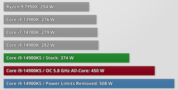

T
What's a few more watts? :)
TPU do measure at the motherboard's 12V connector:
All power measurements on this page are based on a physical measurement of the voltage, current and power flowing through the 12-pin CPU power connector(s), which makes them "CPU only," not "full system." We're not using the software sensors inside the processor, as these can be quite inaccurate and will vary between manufacturers.
Whereas Computerbase do full system (and later package power using the internal sensors), although using Prime95 not Cinebench R20 so not directly comparable. For Prime95 using the CPU sensor they get:
355W, which is actually more than those big Threadrippers although since Prime95 is not something they benchmark it is hard to see what that means.
We do know that for Cinebench R20, the 7980X is way over twice as efficient (scoring 37,070 using 505W vs the 14900KS scoring 15,629 while using 522W). And CPUs with a similar score to the 14900KS like 7950X use 329W, and a bit behind that a 7950X3D uses 233W (all whole system measurements).

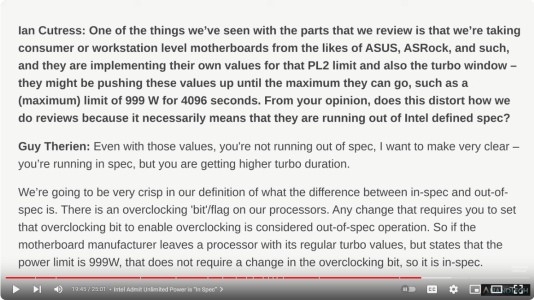

Hitman928
Apr 15, 2012
6,751
12,482
HUB video cites Cutress from an AT interview:
999w is IN SPEC.
Interview from 2019:
Yep, the tl;dw is that Intel has told MB makers and reviewers for the past several years that unlimited power settings are still considered in spec. So Intel has not just ignored this behavior by MB makers but condoned it, which was obvious to those willing to see it, but now there are receipts as well.
