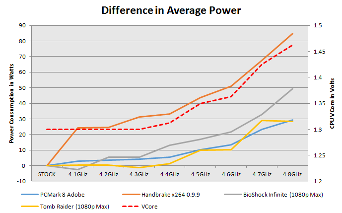

LOL... The FX-6300 at 5GHz? Is that all? The value proposition of the FX-6300 kind of tanks when you need to buy a more expensive MB to power it and a $80 cooler to keep it cool.
Yea, the i3 is 50% faster in single thread, which MOTOR neglected to mention. And despite some software becoming more highly threaded, single thread performance is still very important.
Not to mention that the FX uses more power already, will use even more if overclocked, and has no integrated graphics. But as I said also, the choice depends on the use case. For heavy multithreaded work, a case can be made for the FX. Otherwise, for light use the pentium is fine, or for gaming i3 is probably faster overall.
