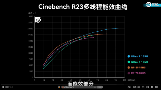

New results for MTL, that is pretty close to being apples/apples. The laptops being compared for all of these CPUs are ROG G14 & G16.
Interesting to see how well Hawk Point performs. It performs well enough to hold off MTL from getting a clean win, which was surprising to me.

That looks interesting. Ultra 9 beats Ryzen 9 by a wide margin!
Is it a one off result? Cos, it's in stark contrast with older results where Ryzen was kicking Ultra's behind.

Hmm, seems to be a significant difference between the 185h and 155h here. Is the power limit here PL1 or PL2? The JT video on the Asus model with the 185h showed no real difference between it and the 155h when limited to the same power and more closely matches the 155h shown here at 28 w.
Edit: I think JT isn’t a strict limit either, actually, until you get up around 30 W as the Asus has a much lower PL2 than most others.

These curves are boggus, the 155H and 185H perfs increase about linearly with power from 10W to 30W, there s no transistors that scale like this, at the very best the curve is a root square law when it comes to perf/power and of course a square law when that s power/perf.
This can be possible only if there s a turbo whose power is proportional to the base power at each curve point, in wich case the perf/power is artificialy inflated by benching at say 25W for a 15W base power FI.

The 8945hs is marketed as having a 45W default TDP. If the 185h really was able to match the 8945hs at this power level, it would be a big deal for Intel. Problem is that I'm pretty sure the power levels shown are PL1 settings and not a hard power limit being enforced, so the extra power the CPUs are allowed to use from the PL2 window is coming into play.
Edit: To illustrate, NBC has benchmark results for the 185h in an Asus laptop (review not yet posted but you can still view the benchmark results). The 185h in their review sample scores 12,688 points in CB r23 which is roughly what the above screenshot is showing for the 185h at 30W. However, the 185h in the NBC review has a PL2 of 64W and the CB r23 test isn't long enough to not have that be a major influence. JT's results also showed the 185h at 11,179 with a PL1 of 28 W and PL2 enabled. So I don't think there's any way you could get the 185h to score as shown above without PL2 being enabled and the CPU boosting to above the shown power levels for at least some part of the run.

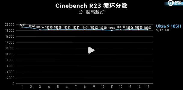

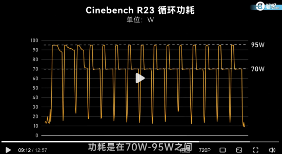

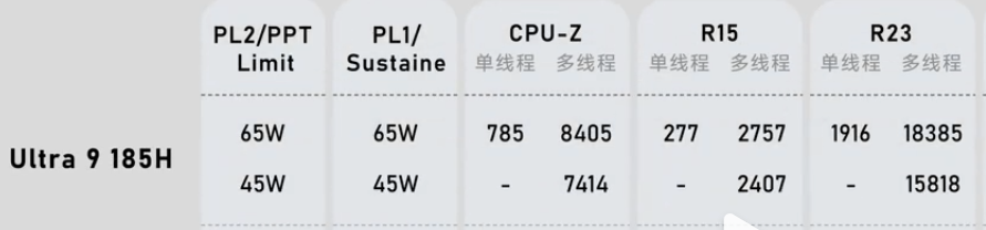

Thanks for find that. In their table, they say they are setting PL1 = PL2 for their power testing, but their power consumption graph with their score for repeated tests doesn't seem to agree:
This is the 185h over multiple runs:
Corresponding power consumption:
So with a base power of 70W and boost power of 95 W for roughly 30% of each run (looking at the later runs), the 185h scores ~18350.
Then, in the table and on their performance over power chart, they show the 185h scoring the same amount with PL1=PL2=65W.
There's no possible way this is accurate unless the PL2 isn't being enforced correctly and it is still boosting as before.

MTL perf/Watt is overestimated by about 20-23% on thoses truncated graphs, it is reported as 65W a score that was actually performed at a 80W average, same for the score at 75W wich is actually performed on the first run at a 92W average.
Indeed why should the 185H be that far apart of a 155H wich is exactly the same chip using the same core count, process and so on, if not by the magical effect of a higher turboing and an even more magical curves doctoring.
