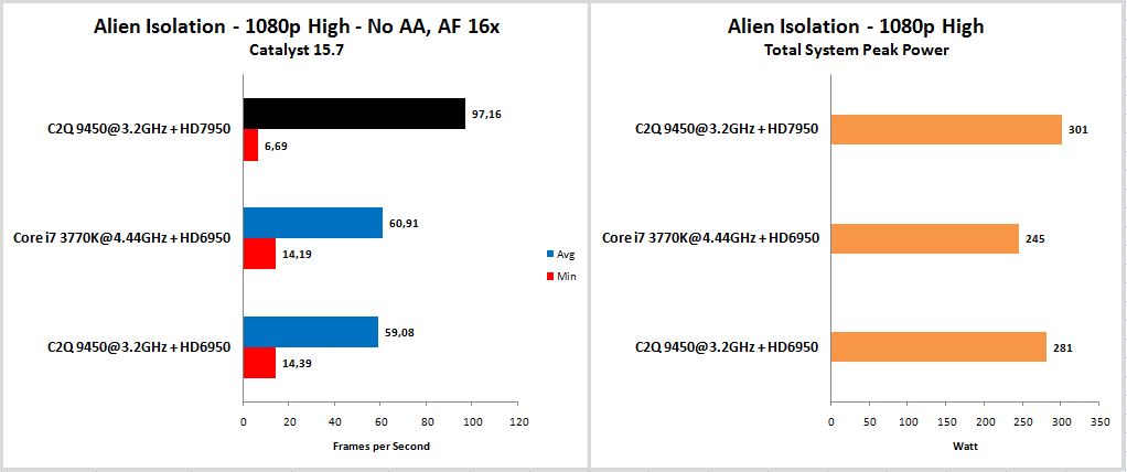

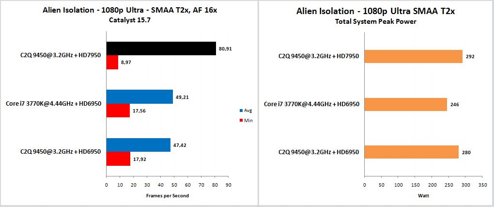

Alien Isolation
The in-game benchmark was used. The game is not very graphically intensive and even with the HD6950 you can play with High settings.
But it still is GPU limited with High settings since you will gain nothing by upgrading to a faster CPU. Upgrading the GPU will increase the performance but even at Ultra settings the HD6950 is more than capable to play the game.
There is a decrease of minimum FPS when the HD7950 was used but that only seen in one part of the benchmark. This may be a driver issue or it could mean that the CPU is not fast enough to drive the GPU.
But since using the HD7950 will raise the average fps by a large amount I believe the lower minimum fps could only be a driver issue.

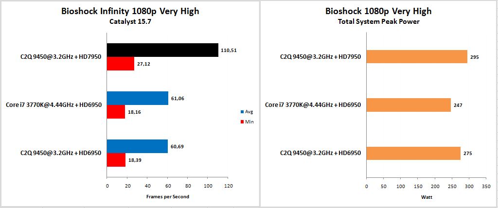

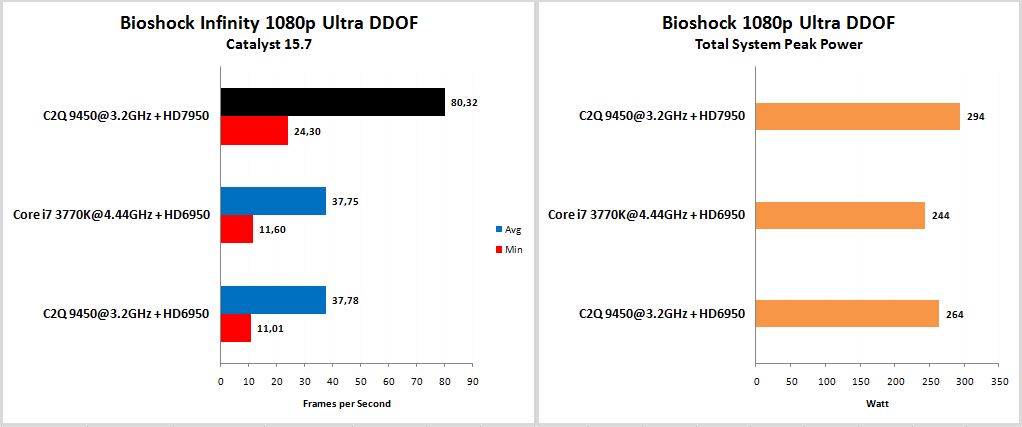

Bioshock Infinity
The in-game benchmark was used. The game is playable at Very High settings with the Core 2 Quad 9450 but again at those settings it’s only GPU limited, so upgrading to a faster CPU will gain you nothing.
Upgrading the GPU will let you increase the Image Quality to Ultra with DDOF and still have more than average of 60fps. At those settings the HD6950 will strangle to pass the 30fps mark.

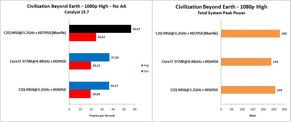

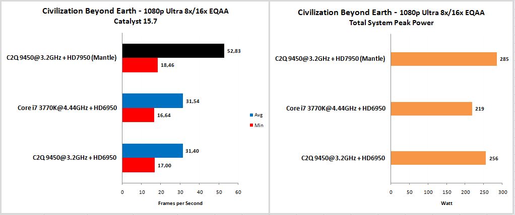

Civilization Beyond Earth
The in-game benchmark was used. Since this is a turned based game high fps is not required to play the game, but higher than 30 fps will give you a better gaming experience.
Also using Mantle will make it even better, so upgrading the GPU is the best path for this game.

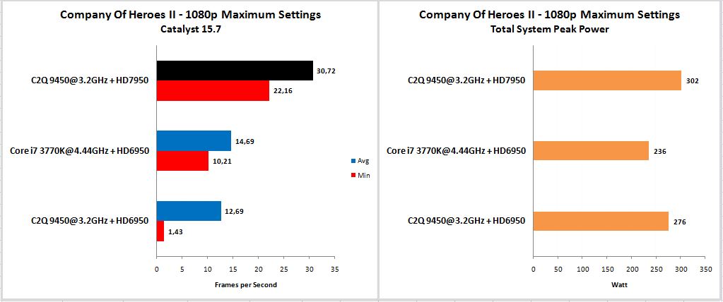

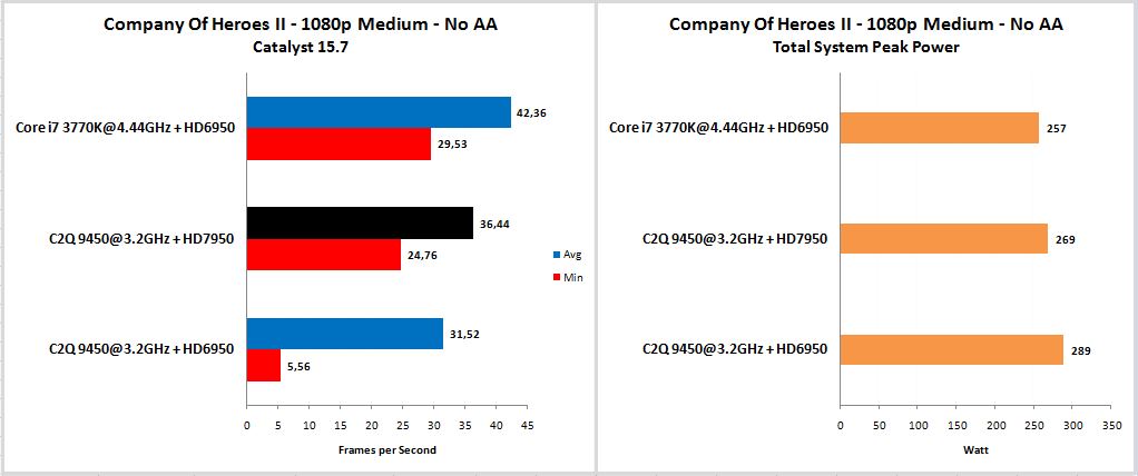

Company of Heroes II
The in-game benchmark was used. Well this game will benefit with a faster CPU at lower image quality settings. But it will also benefit more from a GPU upgrade if you will increase the image Quality settings.
If you are in to a RTS based games, a CPU upgrade may be better for those DX-11 games.

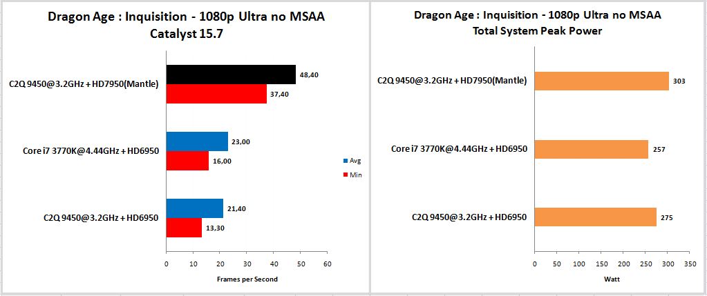

Dragon Age : Inquisition
The in-game benchmark was used. Dragon Age is very graphically intensive game. Using the HD6950 or any other GPU in the same performance level you will need to lower the image quality settings to Medium if you want to play without dropping to sub 30fps.
Upgrading the GPU and using Mantle will let you play with Ultra settings. This game definitely will need a faster GPU upgrade.

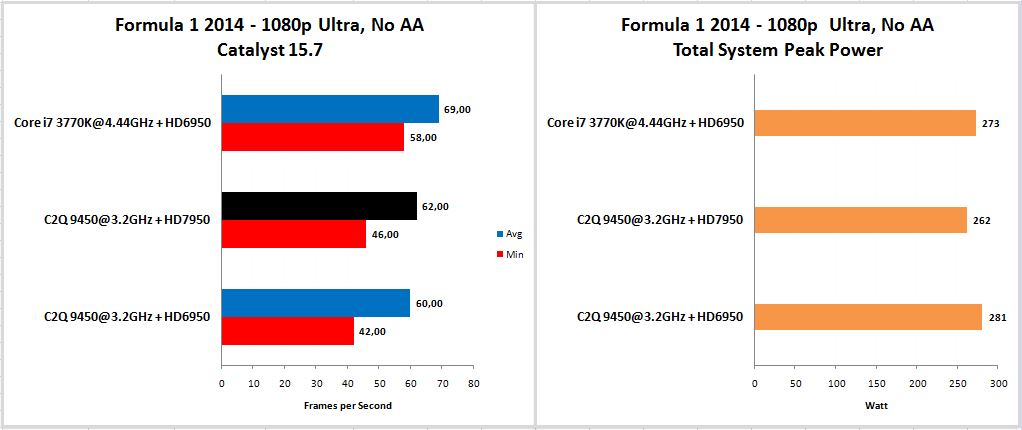

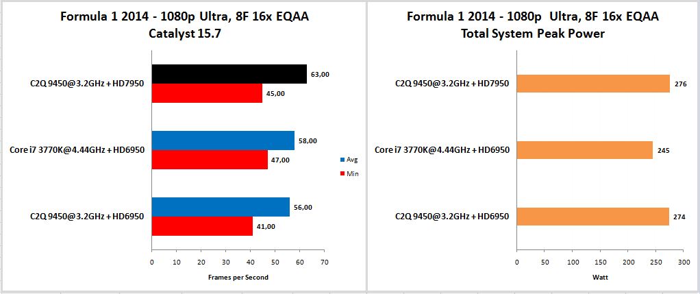

Formula 1 2014
The in-game benchmark was used. This game can run at ultra settings with the HD6950 even when EQAA filters are used.
An upgrade for this game is not needed but the CPU plays a big part here.

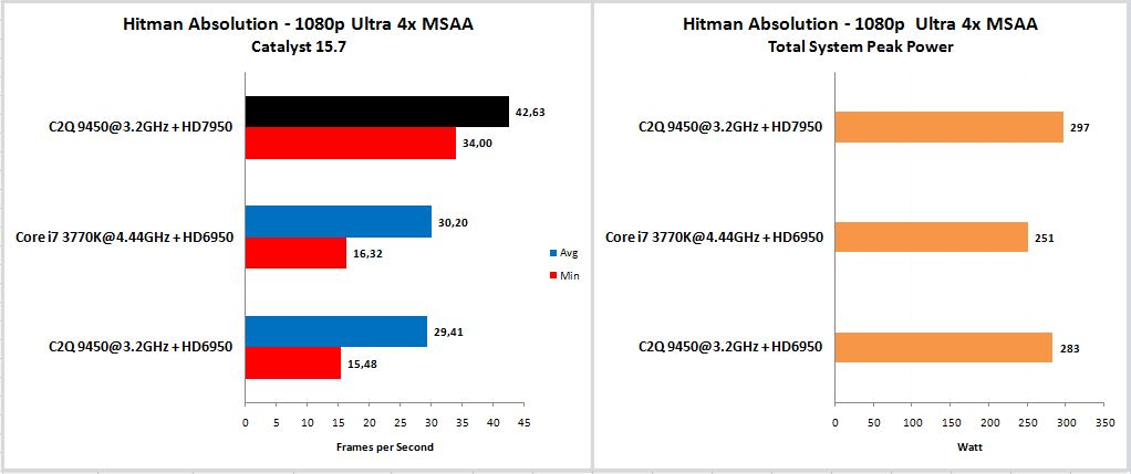

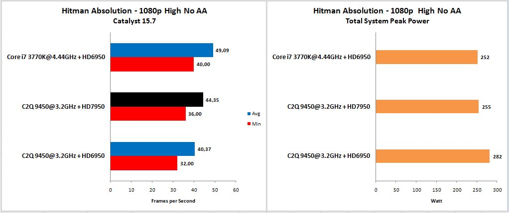

Hitman Absolution
The in-game benchmark was used. At 1080p with High settings the CPU upgrade will give you more performance. But GPU upgrade will let you play the game at higher image quality settings.
With Hitman we can also observe a myth buster. The one that says the slower CPU will not be able to get higher FPS if paired with a high performance GPU.
As you can see at 1080p High settings, using the HD6950 we are CPU limited as the Core i7 3770K is faster than the Core 2 Quad paired with the HD7950.
But look what happens when we raise the Image Quality settings to Ultra with 4x MSAA, the Core 2 Quad paired with the HD7950 is faster than the Core 2 Quad paired with the HD6950 at lower settings.

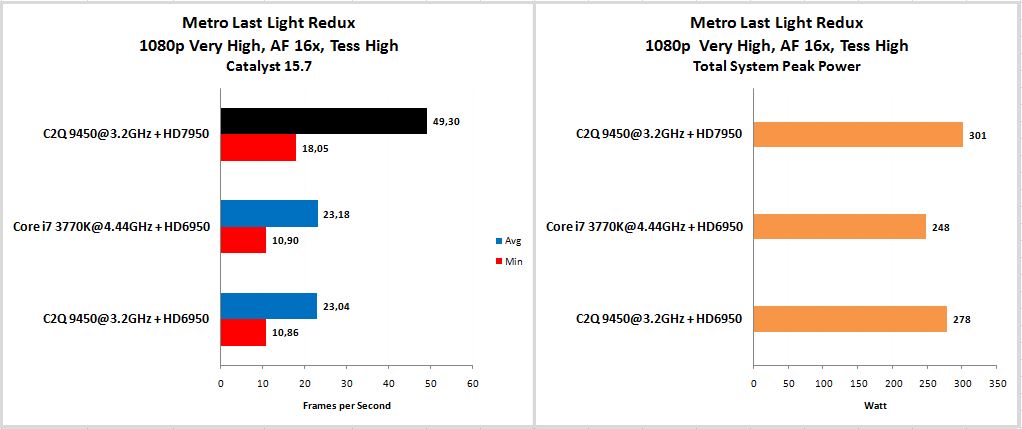

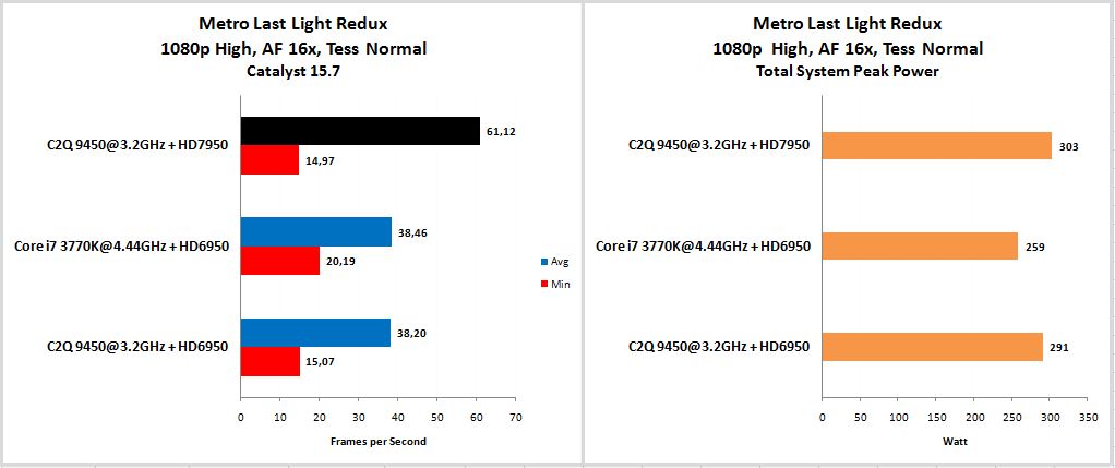

Metro Last Light Redux
The in-game benchmark was used. Metro is very graphically intensive and a GPU upgrade will let you increase the performance or increase the image quality settings.
This game definitely will benefit more with a GPU upgrade path. It will take a very High-End GPU to really feel the need to use a high performance CPU in Metro.

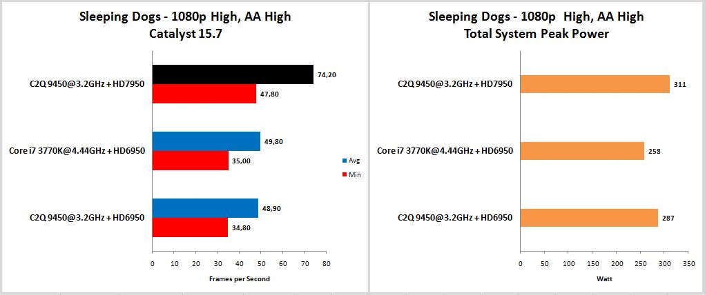

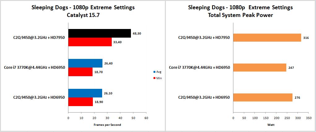

Sleeping Dogs
The in-game benchmark was used. At 1080p High settings the game is more than playable with the Core 2 Quad and the HD6950.
But you will need a faster GPU to raise the Image Quality so the GPU upgrade path is what you need for this Title.

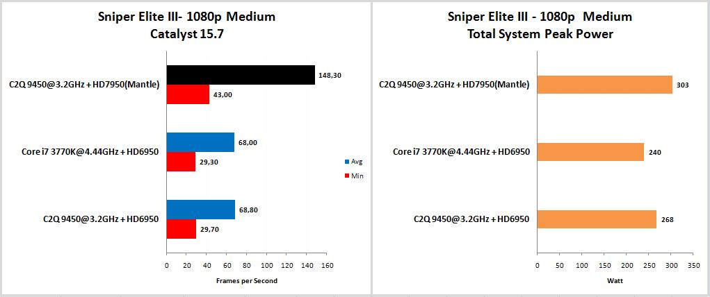

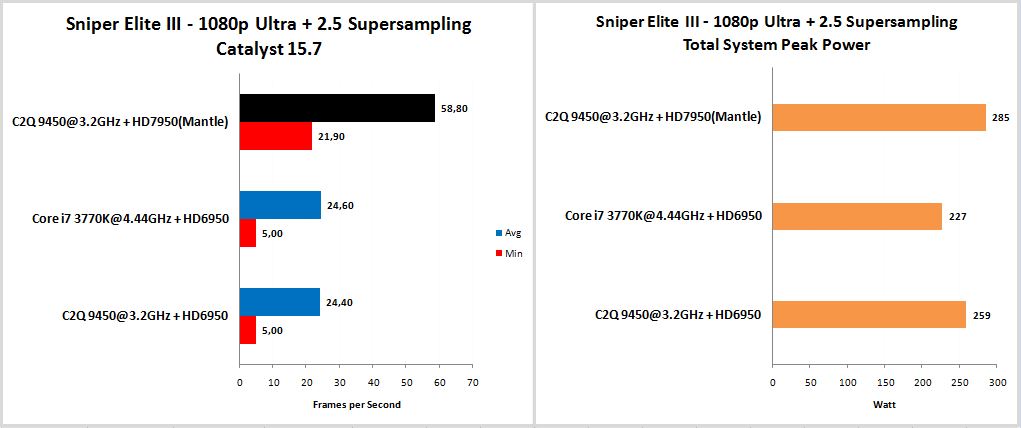

Sniper Elite III
The in-game benchmark was used. Even at 1080p and Medium Settings the game is GPU limited using the HD6950.
Mantle has a tremendous performance affect and upgrading the GPU will let you play the game at Ultra settings and perhaps even with Supersampling if you use the R9 290/390.

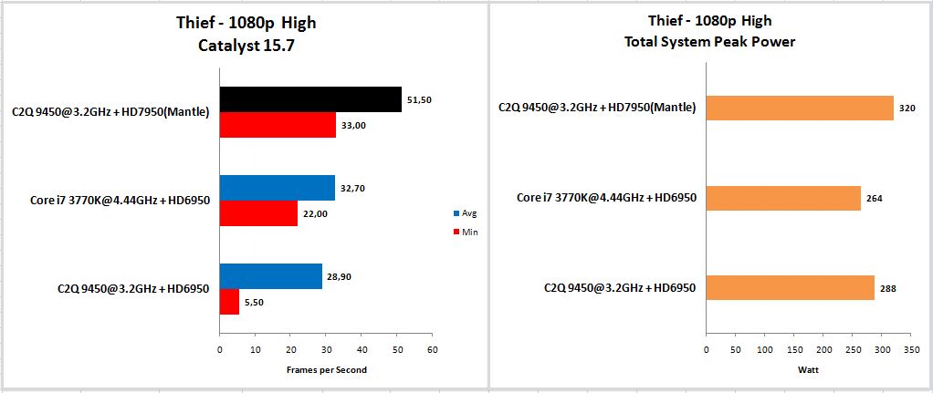

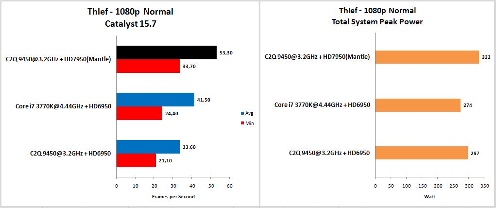

Thief
The in-game benchmark was used. Thief is using a modified Unreal Engine 3 Game Engine and although its very CPU intensive, by using Mantle can allow you to pair a slow or older CPU like the Core 2 Quad 9450 with a very fast GPU to increase the Image Quality settings.
This is another Mantle title to showcase the tremendous effect the API has on game CPU utilization and performance.

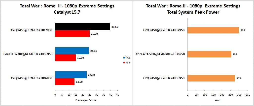

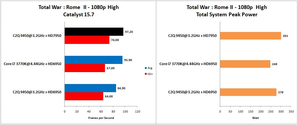

Total War : Rome II
The in-game benchmark was used. Rome II can become very CPU limited or very GPU limited depending on the Map you are going to play.
The in-game benchmark is more GPU intensive than other maps but at higher Image Quality settings the CPU plays a big part as shadows are using the CPU a lot.
For this game I would go for the CPU upgrade because you will need the higher CPU performance for every map.
