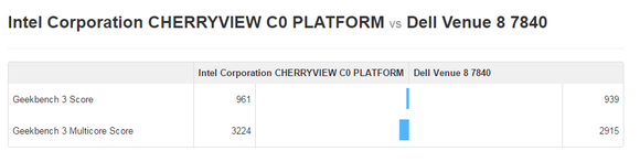

Interestingly enough, Cherry Trail (based on the Airmont core) showed up in the Geekbench database. Let's take a look at how the Cherry Trail chip, which the benchmark claims is running at 1.60GHz, compares with a quad-core Silvermont running at 2.33GHz:
According to the test, the Airmont core in this particular platform is 2.3% faster on a per-core basis and about 10.6% faster when all four cores are being used.
Now, leaks have suggested that the Airmont CPU core as part of the Cherry Trail platform will run at 2.7GHz maximum frequency. So, this might initially lead one to believe that at "full" performance, the Cherry Trail will perform significantly better. However, if we were to scale the results of the "1.6GHz" Cherry Trail to 2.7GHz, we'd get about 1500 for the single-core score and 4915 for the multicore score.
This would be too large of an improvement to expect generation on generation (that multicore score is roughly in-line with an Ultrabook-oriented Broadwell chip), so my guess is that the "1.6GHz" refers to the base frequency and that the chip can "turbo" up to a higher frequency if the thermal headroom exists. This is exactly what the Silvermont core inside of the Atom Z3580 tested here does. (Although Intel does not publish the base clocks for the Z3580, the Atom Z3795 -- built on the same process and using the same core -- runs at a base clock of 1.59GHz and can turbo to 2.39GHz.)

Already posted in BT/CT thread and those scores are not at 1.6GHz, Geekbench lists base clocks, not turbo clocks.

This is a dumb question since nobody here knows turbo frequency of either this prototype nor the planned x,x Ghz on finalized Cherry Trail-T. All we know is there is a protoype with 1.6 Ghz (base probably) with a performance similar to the best Silvermont-T models in Geekbench.
