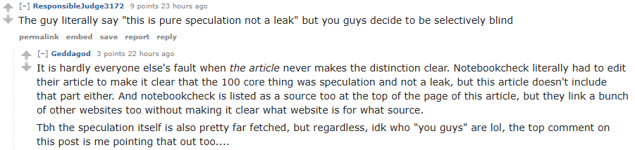

Geddagod
Dec 28, 2021
1,680
1,715
It is in terms of PPW
18A-P is supposed to look best in HPC and high-voltage instances such as desktop. If 18A-P is not competitive there vs N2, I shudder to imagine the difference in the lower end of the v/f curve that the cores in server skus will be handling.
not density
Which is the more important metric for server skus, where static power improvements from physically smaller cores can improve Vmin or near Vmin perf.
and N2 was their backup plan
Despite other tiles on NVL also being on 18A-P? And PTL launching before NVL on 18A? And so much of the rest of their products being internal that if 18A-P or 18A doesn't work, the entire company nears bankruptcy regardless?
I think N2 and 18A-P will have a sizable gap. I think it would be a good sign if 18A-P is near N3P in PPA in terms of just the CPU cores, and not counting other parts of a SoC.
Are they putting 100 E cores on TSMC A14?
