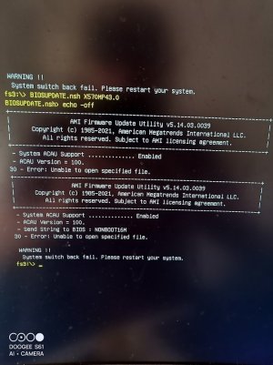

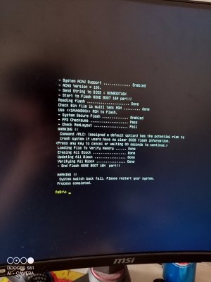

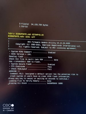

This is what I got after updating to 3.0 then doing the workaround. Fs3: is the only drive(?) that gives me anything other than "30 - Error: Unable to open specified file."
I'm at such a loss and I just honestly don't believe that it's the ram sticks doing it. I tried a single stick in all 4 slots with no changes.
I don't believe it is the RAM either. I just think there is some BIOS version incompatibility you need to work out. My guess is that trying to update to V5.xx with a non 3000 series chip didn't work and something is keeping you from going any further. At this point I would reinstall the 2600 and try to revert the BIOS back to v1.9 using the flash updater in BIOS. That should get you back to square 1. Then try the workaround to the latest version with all of your drives disconnected, including the M.2. You also might try a different USB drive?

It does indeed show the contents. Thank you for this little tidbit. I was able to confirm the drive.
I think the problem is that any BIOS past 2.8 requires a Matisse CPU. So he has to get back to a version prior to that before he can perform the alternate update.
I believe this was the issue. I updated back to 1.90 and then updated via the UEFI workaround to 3.0. It actually scared me a bit because after the bios update my screen went blue and the mouse made the screen all glitchy looking, like the screen wasn't refreshing. I ended up cutting power and installed the 5800x3d. Took a few moments but it did end up booting and I was able to sign in. It seemed to be working fine, although I didn't have the time to look stuff over and test the system. I won't be back to test it until the start of next week unfortunately but I am very glad we were able to get it figured out. I appreciate everyone's help on this and I hope anyone else in the future finds this helpful.
