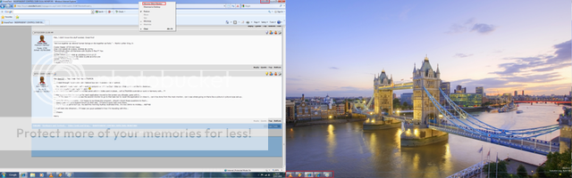

You can leave the software (and obviously the drivers) in place that came with the GPU card. At least it was okay for me when I left ATI Catalyst Control Centre in place. I'm assuming its the same with the Nvidia s/w.
http://i429.photobucket.com/al...lson123/Untitled-2.png
Note that the first (main) monitor is on the left and the second monitor is on the right with a physical split in the middle between the two.
The attached screenshot shows the two monitors. Essentially the icons for the active / inactive windows are shown on the second replicated taskbar. You also have two buttons at the top of the active window (I'm not sure what the proper name is for this) which allows you to switch that window between the monitors (second button) and also stretch the window between the two monitors (first button). You can also set up hotkeys to do this, amongst other functions. You also have the 'switch between monitors' function in the right-click menu. I have highlighted all this stuff in the attached screenshot.
You can close applications which are shown on the second monitor via the first (main) monitor. The only thing I haven't been able to do, and this could be because I haven't set it up correctly, is switch an application shown on the second monitor to the first monitor only using the first monitor.
Hope this helps.
Edit: Below is an enlarged screenshot of the right click menu and buttons on the top of the active window (Photobucket made my screenshot tiny)
http://i429.photobucket.com/al...lson123/Untitled-3.png
Edit 2: Spelling. Argh, I need a spell checker.
