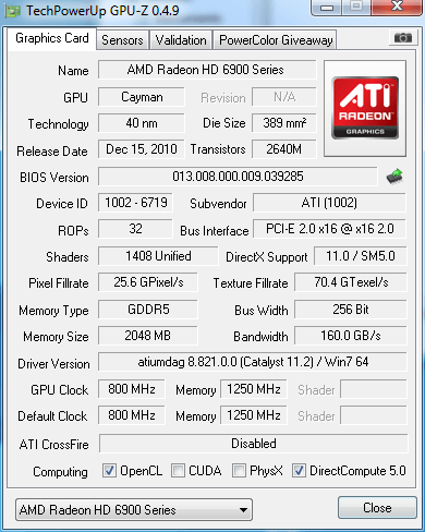

GPUZ screen shot? Let's make sure you're not at 1xPCIE or something.
No, the new 6950 is running at the exact same clock speeds, in the exact same slot as my old Sapphire 6950. All of the games have the same settings too. I did a reinstall of the drivers using driver sweeper so that shouldn't be the problem.

Use gpu-z built in camera/ screen shot - upload function to post a screen shot as Spyder mentioned.
Sometimes installing a card in slot the gold pads don't seat correctly and you can end up not getting 8x lanes or 16 or whatever its supposed to be.
Cool, thanks... that just rules out some possible problems.
